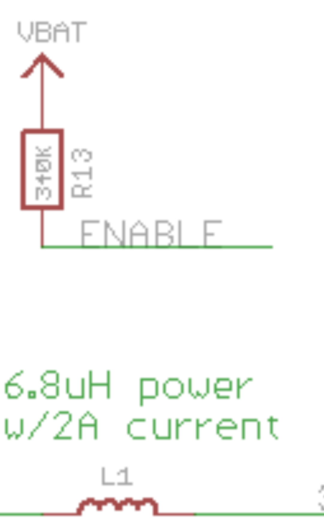

Here's a simple idea. It may be too crude, and waste too much battery power.
You don't need to short it to ground.
The pull-up-resistor on board the Adafruit PowerBoost 500C is quite a high value (340K):
Experiment with different resistor values to find the highest value that will reliably pull the EN pin low and turn the circuit off. Higher is better because less battery power will be drained when the circuit is off. Let's say that's 33K.
Put a push-to-break (normally closed) switch in series with that pull-down resistor. When pressed, the EN pin will be pulled up and the circuit should switch on.
Also connect a Teensy pin to the EN pin via a second resistor. Experiment with that resistor value to find the highest value that will (in combination with the 340K pull-up) overcome the pull-down resistor and keep the circuit switched on. Let's say that's 3K3.
When the circuit is off, the battery will be drained through the 340K+33K, which should be only around 10uA, plus the 10uA consumed by the booster.
The Teensy can keep the power on by setting that output HIGH. Around 100uA will flow from the pin.

I actually don't mind this idea - The pull-up resistor looks easy enough to desolder, and then assuming that leaving EN floating will not enable the regulator circuit, I just use a push-button to tie and extern 340k resister to VBAT. Sounds about this simplest solution.
Then don't look at it and forget anything you saw there.
Bad assumption unless the datasheet explicitly says so
The datasheet for the TPS61090 boost chip states:
Says nothing about a floating input on EN.
