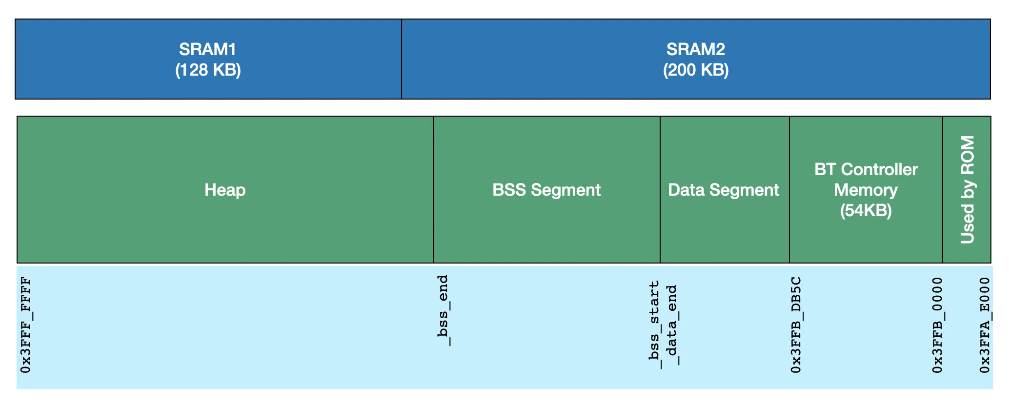

I have created a complex (at least for me) little auto gauge that uses an ESP32S3 Dev board, LVGL, CAN BUS, GPS, TPMS, Bluetooth and Wifi.
It all works well save for some errors and crashes when I switch from one of the screens.
Some background: the gauge has 8 screens, and on all but one, BLE is active and using the antenna. On the other screen, BLE gets deactivated and WiFi is activated so that the user can log into the gauge to set some preferences as there's no user input directly with the gauge.
The ESP shares the antenna between WiFi and BLE and I need both to be available for different functions (BLE for the TPMS and WiFi for an access point to set preferences) so that's why the screen switches which radio gets access to the antenna.
When I switch screens from the WiFi-active screen, it crashes and freezes and I have to reboot the board.
