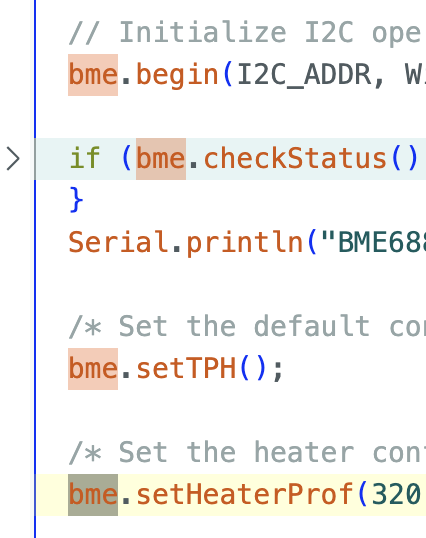

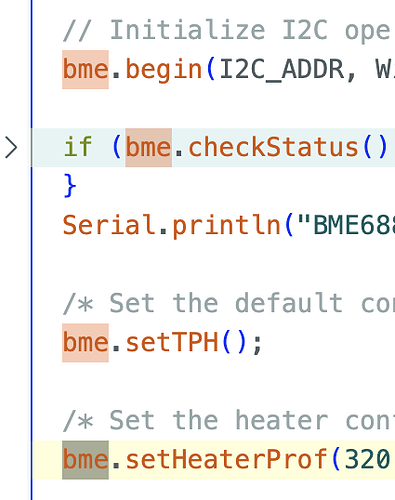

// Initialize I2C operation
bme.begin(I2C_ADDR, Wire);
if(bme.checkStatus())
if (bme.checkStatus() == BME68X_ERROR)
Serial.println("Sensor error:" + bme.statusString());
return;
else if (bme.checkStatus() == BME68X_WARNING)
Serial.println("Sensor Warning:" + bme.statusString());
/* Set the default configuration for temperature, pressure and humidity */
bme.setTPH();
/* Set the heater configuration to 320 deg C for 150ms for Forced mode */
bme.setHeaterProf(320, 150);
