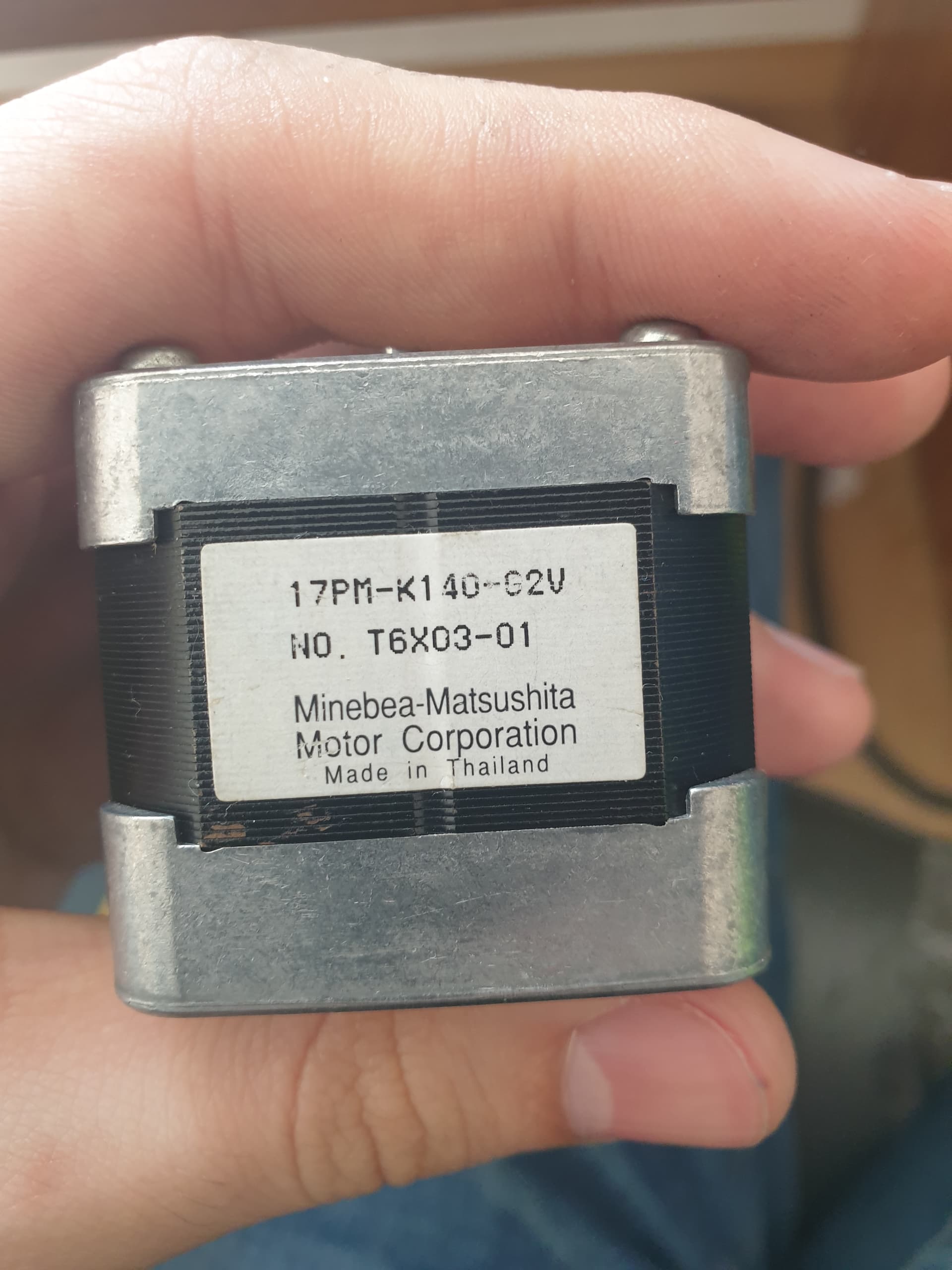

Hi, its me again. So I have this stepper "nema 17" from old printer and it is 6 wire unipolar motor.
So I connected it to "bipolar" driver a4988 and I left 2 wires, one from one coil and one from another not connected. And I thought that it should work because it is like bipolar stepper if I dont connect two wires but motor wasnt moving, just weird noise was comming from it and motor was stopped (like it was "holding").
So I am looking for some answers why that didnt work.

So if we look at 6 lead motor, I just didnt connect black and white wire.
Use your multimeter to measure the winding resistances, and report those in your next post.
Printer motors are usually high impedance, and won't work with the A4988 unless the motor power supply and current limit settings are carefully and correctly selected.
I measured them and between (look at the photo above), between red and red/white resistance was 3,7R and between other green and green/white was 4 as I can remember.. Measures betwen so (green white etc.) were about half of the resistance between Green and green/white.
That should work with an A4988. You will need a motor power supply of at least 12V (preferably 24V) and set the current limit to 0.5 Amperes/winding as a start.

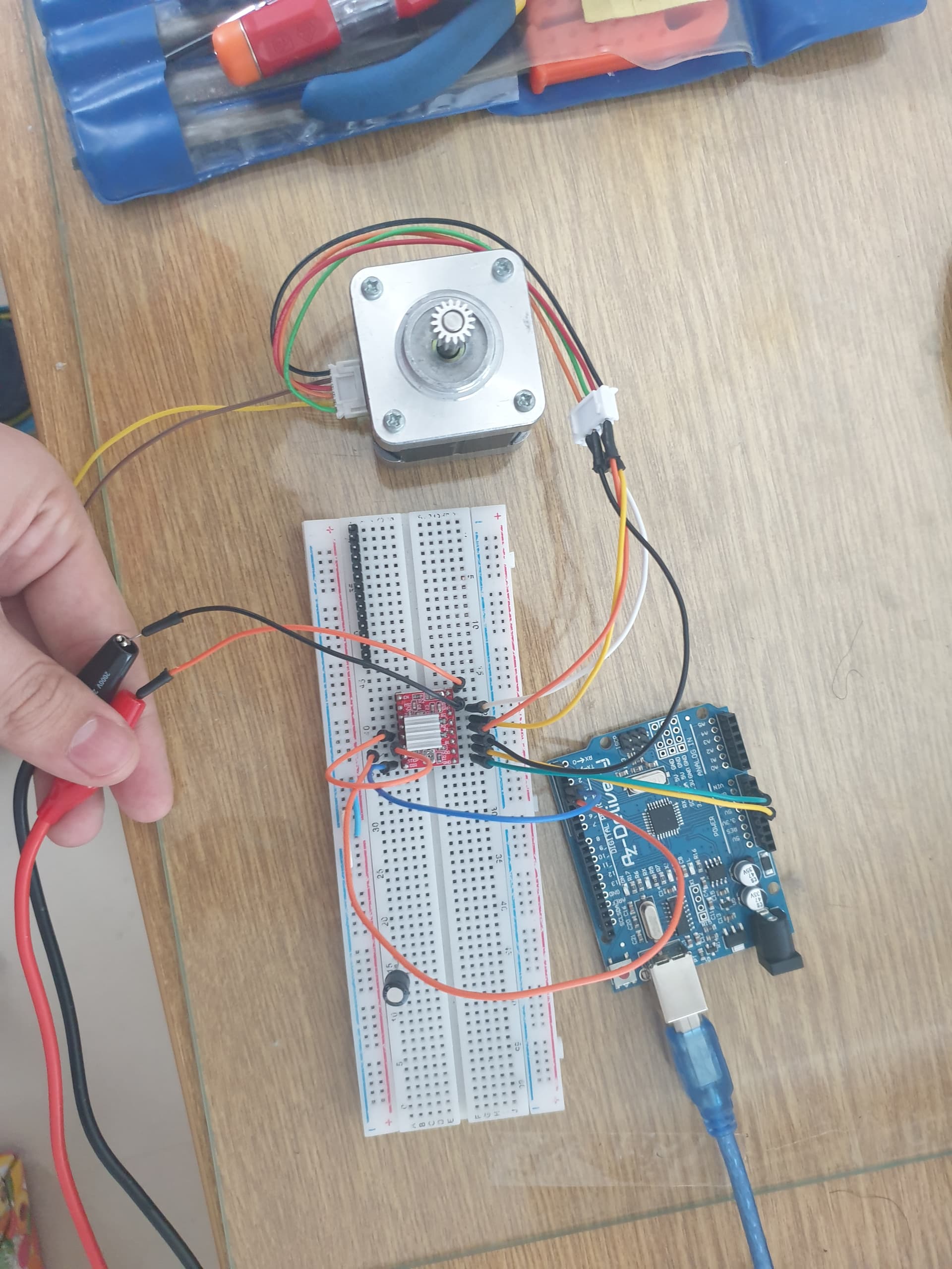

If that is the main capacitor on the breadboard then it is not connected to anything !
Where do the yellow and brown wires go as they seem to go into thin air ?
Normally that cable is only a 4 wire,
You don't appear to have a common ground either ?
What are you using for the driver supply volts/amps ?
Do you know if your board is a good clone or one of the nasty "wavgat" ones ?

Also not happy with how close the heatsink is to the pins ! It should be in the middle of the board approx. equal space away from the pins and stuck down using proper heatsink tape or if needed superglue as some cheap heatsink tape often supplied with Chinese drivers becomes pliable with heat and can move. I use superglue here but only a very tiny drop to keep the heat transfer as optimal as I can.
Use my driver in a CNC shield as it provides a much better interface to the Arduino and allows better customisation
NEMA xx only refers to the motor frame size and NOT to the connections required so be aware of that.
I don't know your final application so that, and your current code may also be useful at this point. along with any updated schematic (even if hand drawn)
Sorry for that. I was trying possible combinations and I didnt connect it when I took the photo.
Actualy yes, they are not connected. Stepper uses 6 pin conector so I disconnected 2 wires because I didnt need them (one motor has 2 not connected pins, other is "unipolar stepper" so it has 6 pins..
At first I had common ground but as I saw online, many didnt connect common ground... so my bad.
I use laboratory psu set to 12v and current limitation to 1.5A
Board isnt the best but i measured all conections and everything has good contact.
