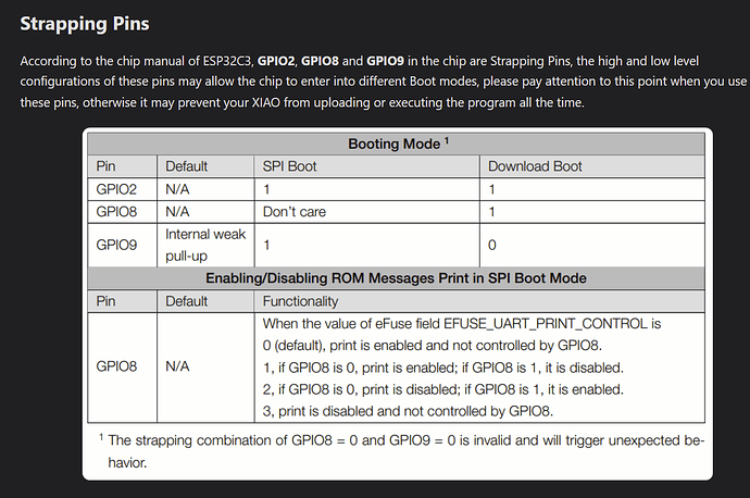

Another note: It looks like some of the SPI pins are used in the startup sequence:
I don't have a logic analyzer with me at the moment, but I put an LED on the SPI MOSI pin to see if there's any activity on it. It looks like that pin has something going on during startup as well as during the setup() call.

I understand that calling hspi.begin() with no arguments will use the pins defined in Pins_Arduino.h, but looking through the implementation, it does seem like you can override these pins by passing parameters. Either way, it doesn't seem like the display is working with this board whether I override the pins or not. Unfortunately, it looks like the SPI pins are also used as strapping pins, although I don't really know what that means.

According to the datasheet, GPIO8/D8 and GPIO9/D9 are both strapping pins, so if I want to use SPI at all, it seems impossible to avoid using them while using the pin definitions in Pins_Arduino.h. As additional clarification, I was able to get the sketch working no problem on the S3 development board, even with a) manual pin remapping and b) using SPIClass::begin. However, the sketch I'm attempting to get running now adheres to all of your suggestions, except for the usage of SPIClass spi(FSPI) that is suggested in the GitHub issue that you linked.
