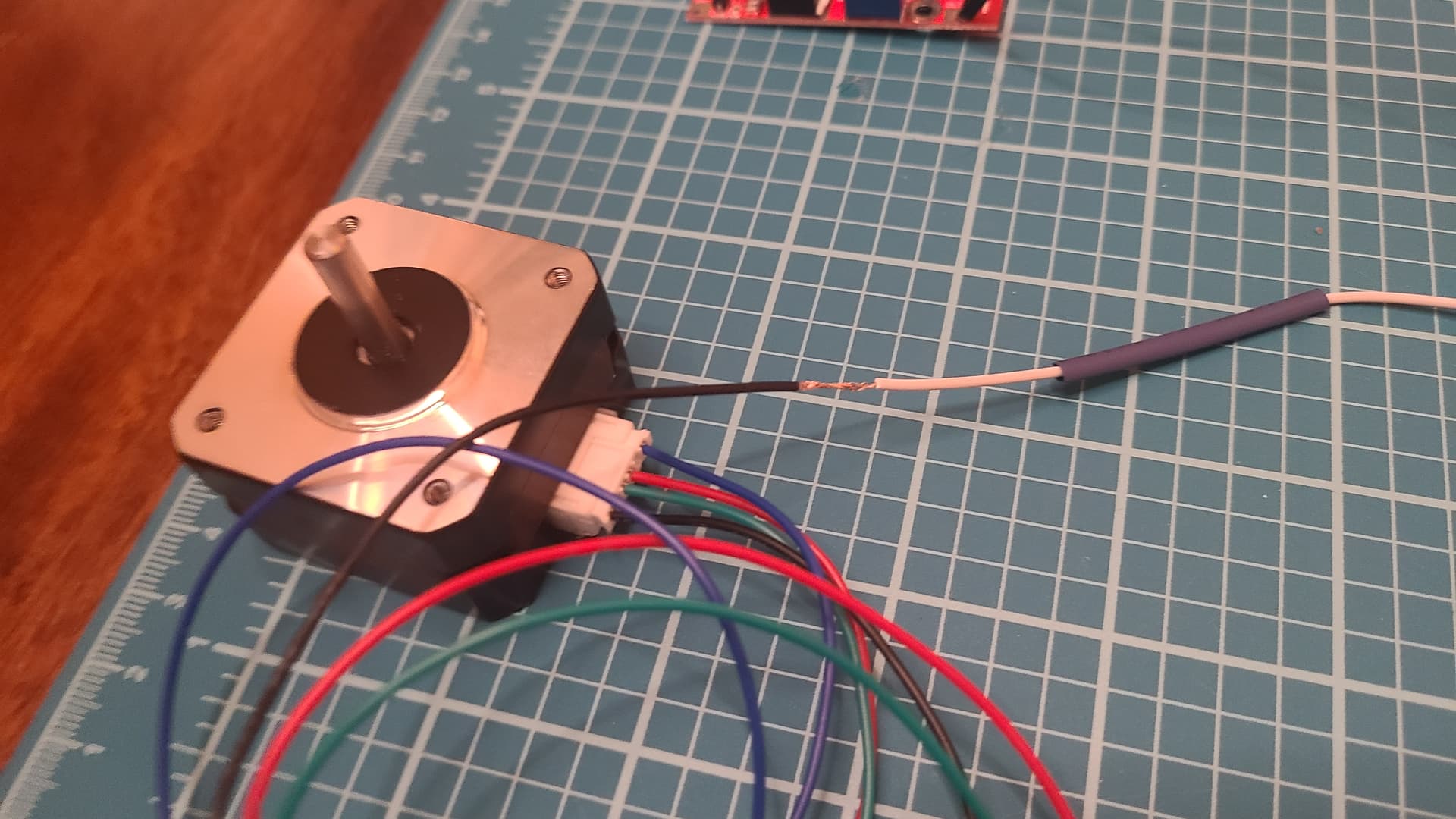

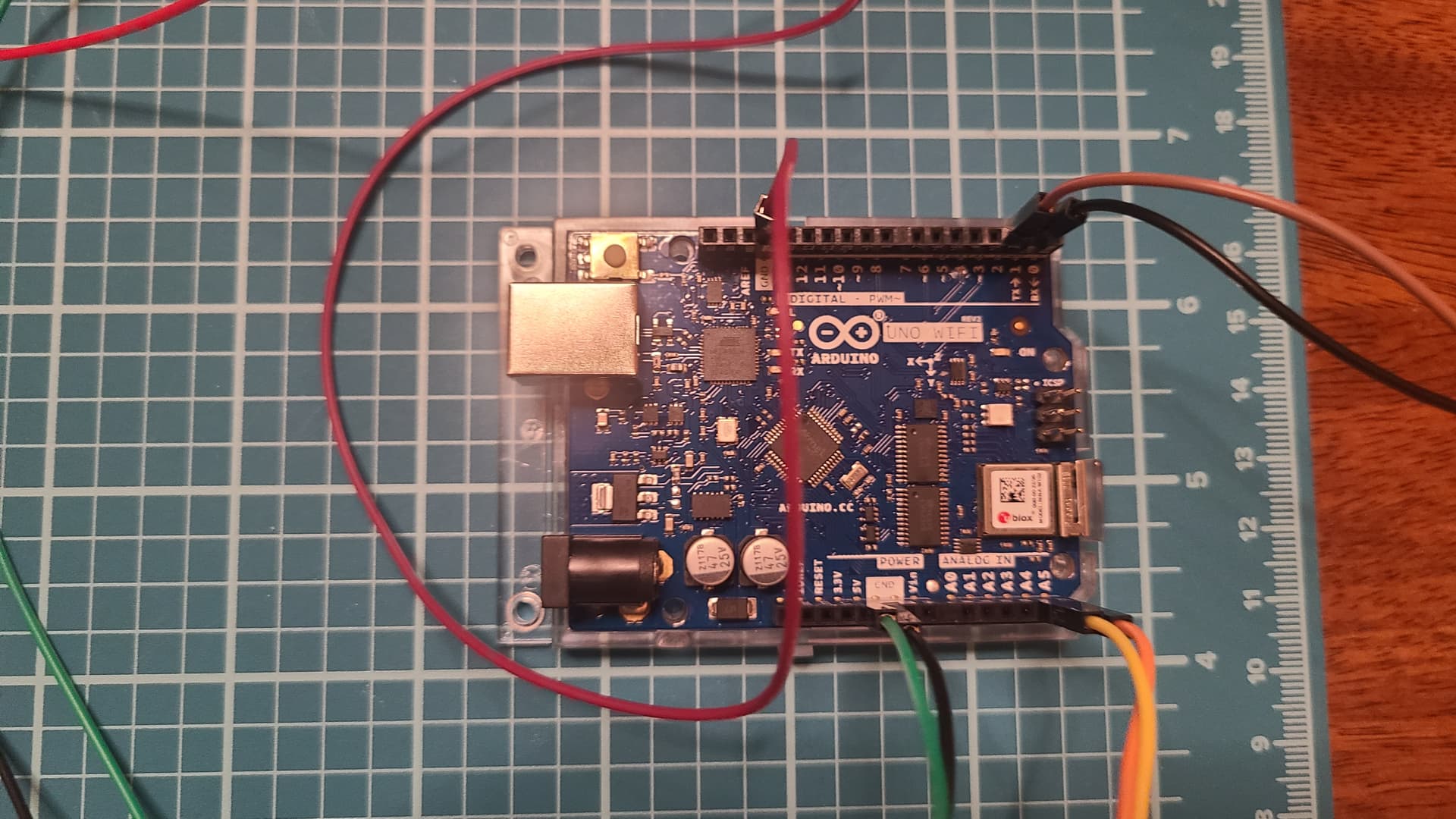

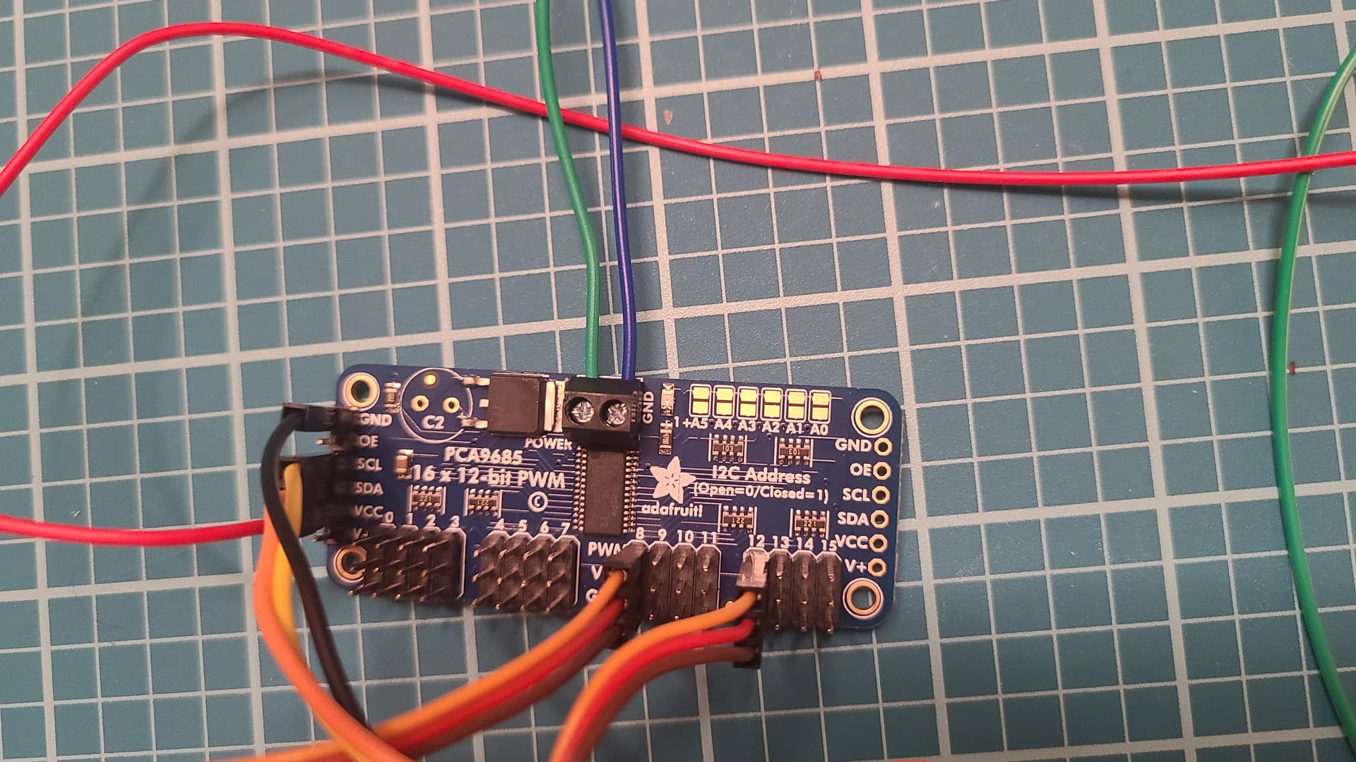

They all recently arrived. I can't power anything though because one of my batteries came defective, so in the meantime, I planned out the connections with the parts. I just used jumpers to represent the connections, but some will be soldered on (the BMS board, and the converters). Also, since the stepper came with just a regular wire, I think just splicing it with a jumper cable should work, like in the picture? This circuit hasn't been powered or tested, and the power to the Arduino isn't shown(neither is bms->convertor) because I don't know whether to use the 5v pin, VIN pin, or the barrel jack.
Thank you for getting and showing your lovely parts. Check one peripheral at a time using PC and Arduino. At the end, power your Arduino from 7V -12V Battery through barrel jack.

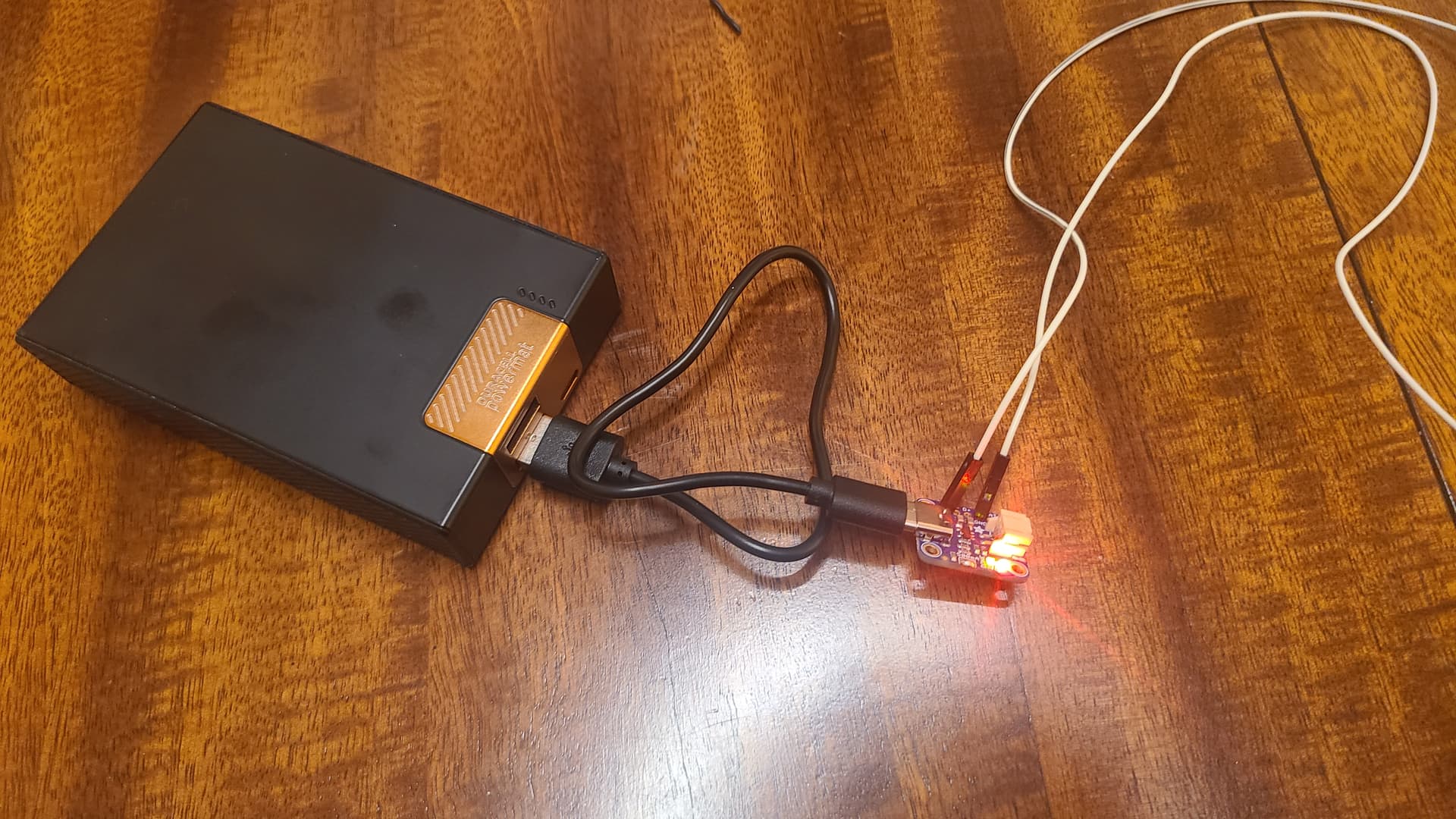

I'm currently trying to power just the Arduino, but my BMS board is only outputting 2.4V instead of the 7.4V I need. I've made the connections right, the batteries are full (~3.8v and ~4.1v), and I am providing an 8.4v charging supply to the P+ P- pins. Any idea why this isn't working?
(I haven't soldered the charging connection on yet, as I am not sure about that part of the circuit)
