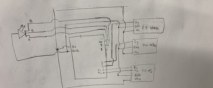

This is how it's currently wired (: thanks for the help everyone I'm trying out your suggestions right now. Will update you guys on the results

You mean to try fix it in the Arduino if that's where it starts out once the sensor produces the value, rather than send it to AI to fix it and send it back to where it started?
I've also attached the arduino code here, if that helps.
scoreboard_edit_ino.ino (7.07 KB)
I'd be keen to hear, without having to wade through code, if the "faulty" versions of the sensor values FE and FF exist as FE and FF inside the Arduino before you send them to AI for "fixing". Since if they do, it seems you can "fix" them there and then....
Can you explain more about the architecture, and what is the role of the Android app. I don't see any Serial.read() for data back from Android to Arduino.
Is the AP inventor issue with the output from setShot(int mode)?

So the Arduino App is mostly for determining whether the shot was made or not. The sensors are hooked on to the UNO and it's supposed to send 1 or a 0 depending on if it's a miss or a make. I also hooked up the LED to help me determine which case is occurring. Like it shows green then I know the prox sensor was the only sensor triggered.
I don't think the issue is with the setShot(), because when I used a serial bluetooth monitor to see what values were being sent, I got: 0xff = miss and 0xfe= score. I think the underlying issue is what I'm reading from the App.
Is it not setShot() which is doing the sending?
If instead of setShot(int mode) you use setShot(char mode) what do you see at the Android end.
setShot('1');
setShot('0');
