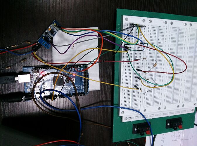

Hi everybody,
I currently tried to use simplemodbusmaster library to communicate with PROCON module PM8TCISO and PM16DO (PROCON modules).
First I tried successfully with modules using direct communication with Labview, then I would like to use my M-DUINO as a master (Arduino mega with different shields) http://www.industrialshields.com/m-duino-plc-arduino-34R-i-os-relay_analog-digital
I tried to use the A and B pin (MAX-485 connect to serial 3 of arduino mega).
First, I would like to read holding register in PM8TCISO. ModBus address 30002 to 30009.
The communication of module is 9600,8 bits, no parity, 1 stop bits.
Here below the code that I tried to read the first register 30002. I defined in module slave ID as 32.

Benchem,
Address of holding register starts from 40001, but you need to read 30002, means you don't want to read holding registers but you have to read for input registers.
modbus_construct(&packets[PACKET1], 32, READ_HOLDING_REGISTERS, 0, 1, 0);
so here you have to make the change as replacing READ_HOLDING_REGISTER by READ_INPUT_REGISTER also you need to change that last 0 to 2 as you want to start from 30002 not from 30000.
Hope that will work!
Yatin
Thanks for your answer.
According to your answer I modified my code but nothing change.
#include <SimpleModbusMaster.h>

When I used Labview to send a message on MobDus to request the previous I send (decimal visualisation) :
32 <-- slave ID
03 <-- fonction code
00 01 <-- register adress
00 01 <-- number of register to request
CRC code
When I read the message send from arduino it something very different :
in hex
00BB FFBB FFFD D322
Thank you
benoit
Benchem,
you need to check whether it is transmitting proper data and how it response to received so make a proteus circuit with lcd and check what data u getting yoc can check the tryal program that i used on my post #452!
20 03 00 01 00 01 D3 7B this is what master should send for slave id 32 and starting address 30002, function 3 no of reg 1 and D37B is crc! it show some thing different on lcd due to ascii but yes you can try with proteus and if it runs there you can check lcd data over there and in actual at your hardware.

Hi everybody,
I solved my issue next to a feedback from industrialshields. I had to use a modified simplemodbus library and carefully define my RS485 pins and defined it in modbusconstruct.
Here you can find now if it can help someone my code to read input registers and write single register to my 5 Promux slaves.

Hello all,
I am Nike, working with an energy meter (Schneider Conzerv EM 6436), and trying to read the register values using modbus. I saw the post http://forum.arduino.cc/index.php?topic=176142.15 and went through the entire thread (took nearly 2 days).
I followed the schematic at https://aglasspool.files.wordpress.com/2010/03/diagram1rev3.jpeg. I modified the connections with necessary resistors and Arduino Yun is master and conzerv meter is slave.
I tried with the simpleModbusMaster example with necessary baud rate, slave ID and couldn't get any response. Please help me out. I am here by attaching the manual of energy meter.
Manual : http://www.powertechinternational.in/catalouges/SCHNEIDER-CONZERV-EM-6400.pdf
Thanks in advance
Nike
Hi Nikeroy,
Please post your exact code (with your changes) And also your schematic so we can check where the exact fault is and can help you further!
Thanks!
Hi Yatin,
I have attached both my code and the configuration schematic. Here Uno/Yun is master and Conzerv energy meter is slave. (Manual of meter Manual : http://www.powertechinternational.in/catalouges/SCHNEIDER-CONZERV-EM-6400.pdf)
I have changed the register addresses from 3900 to 43900 or 0x0F3C etc. But, couldn't succeed. I am using SimpleModbusMasterV12 (their *.cpp and *.h files are attached).
I am using both the schematics with and without capacitors, and also changing the resistors from 680 ohm to 510 ohm (according to JuanB's manual)
Let me know which part am I missing.
BR
Nike

Nike,
Looking at your code I notice something that I am surprised you haven't picked up if you read the whole thread, where it is mentioned on more than a few occasions that with a small Arduino, such as an UNO, there is only one hardware serial port to use.
From looking at your code, you are trying to use that one serial port for both Modbus and to do your serial prints.
Additionally, when you use a serial port for sending of data, you first need to initialise the port with a serial.begin(...), which you don't have in case you were wanting to use the serial port for serial.print(...).
But remember, if you are using this on an UNO, you can only connect the hardware serial port to only one device, either your computer, via USB or to the MAX-485 chip that then talks Modbus to the Modbus slave.
The other thing to test, once you get that sorted out, is to swap the IEA-485 lines, that is swap the A and B lines, as I recall there was mention that some MAX-485 chips had the pins swapped. You need to confirm and clarify this claim, though swapping those lines should cause no ill effects anyhow.
Paul
