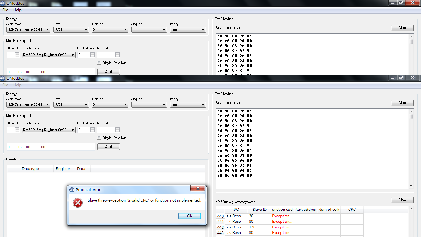

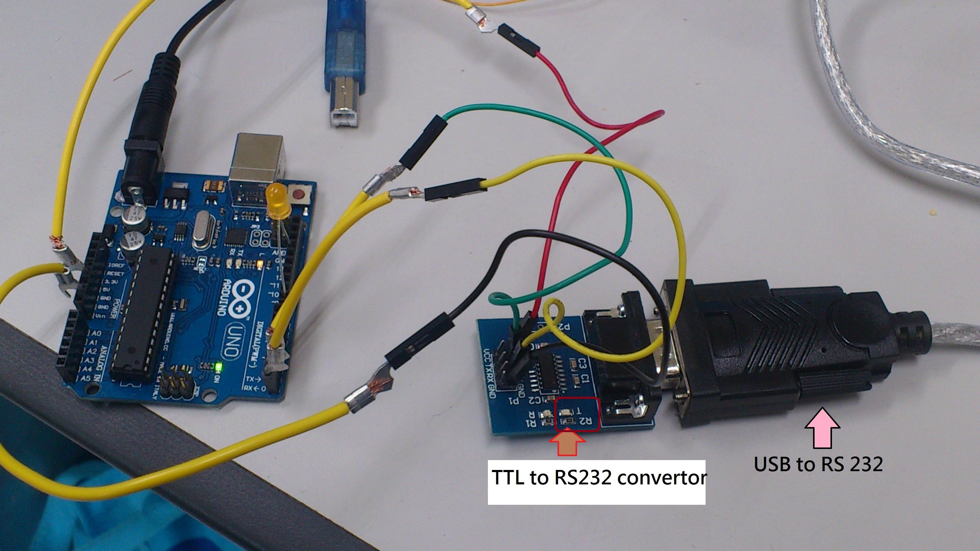

Hello suby,
Thank you made a example for me I really appreciate your help. But i am still in trouble :frowning: .Your code work very well in USB port
But when I want to connect arduino via RS232 it's still no response.
Modbus slave(1,0,0); In your code the third parameter is 0 so I decide connect it via RS232 and don't change anything.
http://i.imgur.com/nm5COl9.jpg?1 this is my wiring .As far as I know I need a converter to convert TTL to RS232 so I buy
a max232 module.
RX --> RX , TX --> TX , 5V -->VCC, GND-->GND . By the way I tried RX-->TX , TX -->RX wiring it's still not work.
And then I decide to connect it via RS485 so I change this line
Modbus slave(1,0,2);
And I use the same wiring and fail again.
Sorry I am too stupid to make this thing work :disappointed_relieved: I can't figure out which part of my procedure is wrong.
Thank you again.
Hello Platoxii,
I understand that you are using a MAX232 or MAX202 for the RS-232 interface, isn't it? I cannot determine what wiring are you using from the photograph. :fearful:
Then the wiring between it and the Arduino should be:
Arduino pin MAX232
RXD 0 ---------------------- 12 R1OUT
TXD 1 ----------------------- 11 T1IN
GND ------------------------ 15 GND
VCC ------------------------- 16 VCC
You should look at the wiring between the MAX232 and your USB-RS232 interface:
MAX232 USB-RS232
T1OUT 14 --------------------- 2 RXD
R1IN 13 ----------------------- 3 TXD
GND 16 ----------------------- 5 GND
Maybe your wiring is a bit different, but should be similar to this. Please check it before testing your communication.
Regarding to your RS-485 connection, please exchange the green and the blue wires, so
  • T/R+ is tied to MAX485's pin 7 B
  • T/R- is tied to MAX485's pin 6 A
If you are using transmission speed lower than 57600 and very short distances (< 1m), there is no need to use termination resistors.
I encourage you to read thoroughly some manuals to understand the MAX232 and the MAX485. It's the only way to learn these things.
Best Regards,
a max232 module.
I've missed this. The last try seems correct:
  • Arduino RXD is an INPUT and needs to be connected to an output coming from your interface;
  • Same thing for TXD, which is an OUTPUT.
Instead of executing a Modbus example, just try this simple sketch:
 Serial.print("hello world!");
Try it either USB and RS-232. You can use the Arduino Serial terminal as an output in your PC. You should get a "hello world!" message each second. If you don't succeed it with RS-232, there may be something wrong. Maybe your RS232-TTL board. :sleeping:

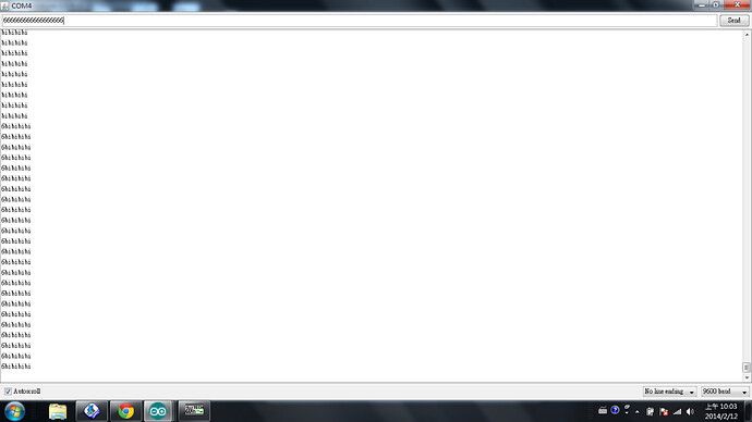

Hello,suby
Yes, I wrote a simple program to test read write via RS232 before .It's work very well.
    Serial.begin(9600); // start serial communication at 9600bps
  Serial.println("hihihihi");
  char ser_char;
  if( Serial.available() > 0) { // if data is available to read
     ser_char = Serial.read(); // read it and store it in 'ser_char'
     Serial.write(ser_char);
By the way , RX-->RX , TX-->TX wiring can read write data but RX-->TX, TX---> RX wiring can't read write data.
I start to think my arduino board is counterfeit. :disappointed_relieved:

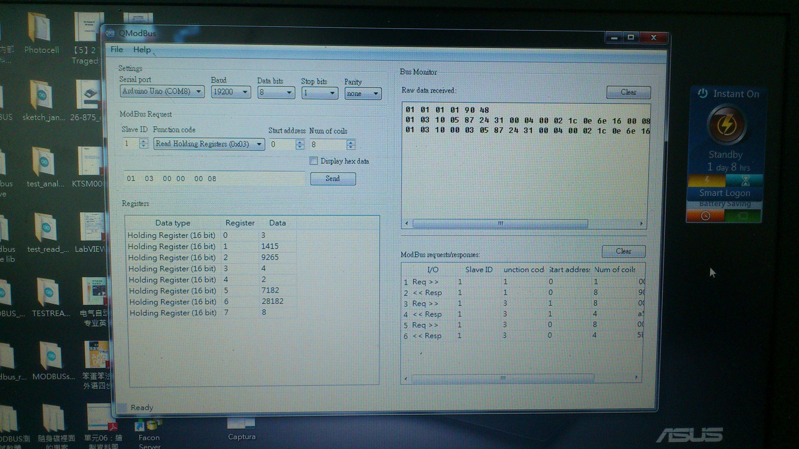

Good news!!It's work not no response but it's seem receive invalid data. :roll_eyes:
And my MAX232 module Transfer Led start to blink
Thanks a million.
Good news!!!!!! I finally did it . It both work very well via RS232 and RS485 you are genius.
