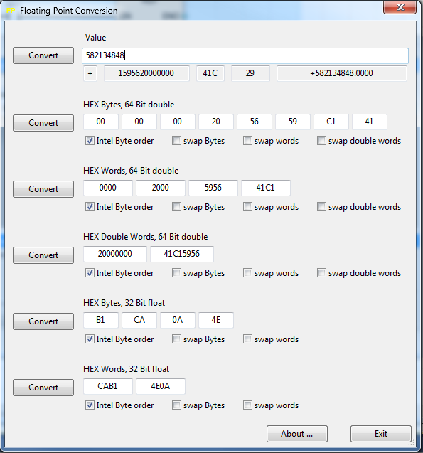

Hi Again!
Now I get more time to look into my problem....
RS485 multi drop working now...I needed to Set the Modbus device assignment in PLC. Any way it worked If I put 0 as start reg address.
Regarding problem to put/split 32bit value to using two consecutive 16-bit registers, I see union function.
 union
    int regsf[2];
    float value;
  } minFloat;
 minFloat.value = 582134848;
Wondering if this code is Ok to use!?
Need to ask, my coding knowledge is poor.
I get right value, see att picture

      regsf(0) = 51889 HEX = CAB1
      regsf(1) = 19978 HEX = 4E0A

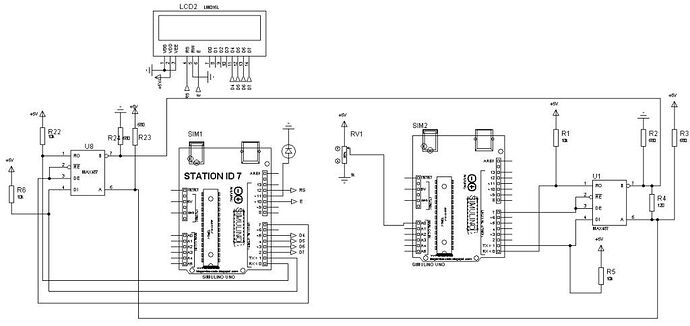

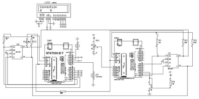

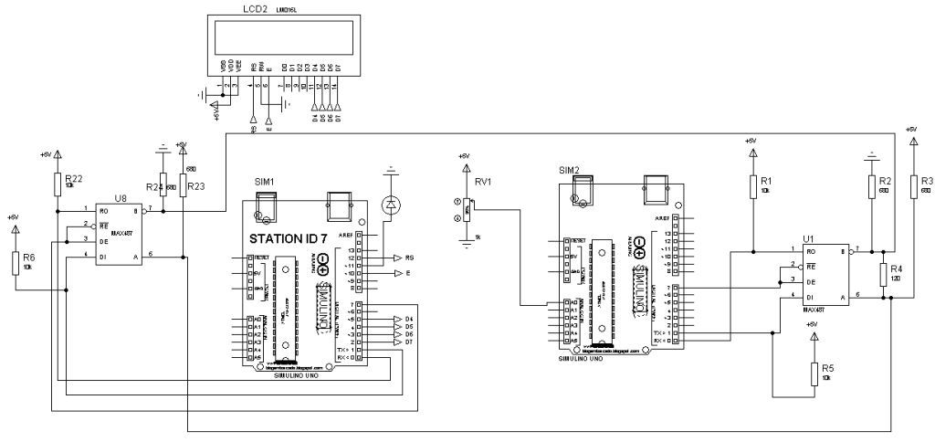

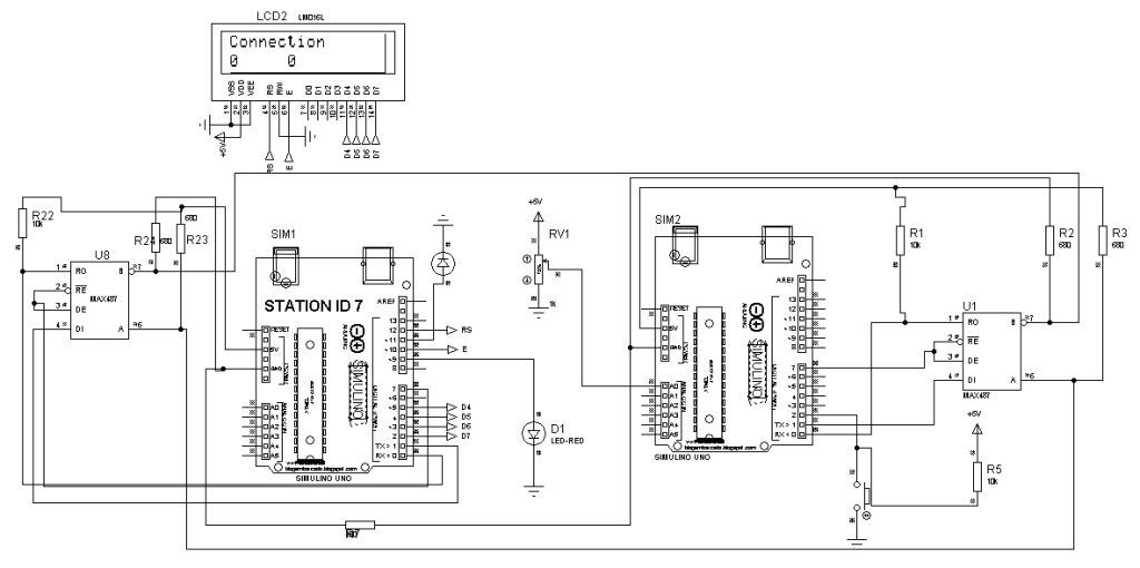

I have been working on MODMUS RTU communication between two Arduino Uno One arduino unso as Master and other is Slave. I am using [SimpleModbusMaste.h Rev2] and [SimpleModbusSlave V10] and RS487 as serial communication chip but I am getting OUTPUT only 0.
Here my code for master
//#include <Wire.h>
#include <SimpleModbusMaster.h>
#include <LiquidCrystal.h>
   The example will use packet1 to read a register from address 0 (the adc ch0 value)
   from the arduino slave (id=1). It will then use this value to adjust the brightness
   of an led on pin 9 using PWM.
   It will then use packet2 to write a register (its own adc ch0 value) to address 1
   on the arduino slave (id=1) adjusting the brightness of an led on pin 9 using PWM.
//////////////////// Port information ///////////////////
#define baud 9600
#define timeout 2000
#define polling 400 // the scan rate
#define retry_count 20
// used to toggle the receive/transmit pin on the driver
#define TxEnablePin 7
#define SlaveID 1
#define LED 11
#define LED1 9
// The total amount of available memory on the master to store data
#define TOTAL_NO_OF_REGISTERS 2
LiquidCrystal lcd(12, 10, 5, 4, 3, 2);
// This is the easiest way to create new packets
// Add as many as you want. TOTAL_NO_OF_PACKETS
// is automatically updated.
enum
  PACKET1,
  PACKET2,
  TOTAL_NO_OF_PACKETS // leave this last entry
// Create an array of Packets to be configured
Packet packets[TOTAL_NO_OF_PACKETS];
// Masters register array
unsigned int regs[TOTAL_NO_OF_REGISTERS];
  //Serial.begin(115200);
  lcd.begin(16, 2);
  // Initialize each packet
  modbus_construct(&packets[PACKET1], 1, READ_HOLDING_REGISTERS, 0, 1, regs); //(packet,SlaveId,Function,holdingregAdress,data,locanstartadress)
  modbus_construct(&packets[PACKET2], 1,  READ_HOLDING_REGISTERS, 1, 1, regs);
  // Initialize the Modbus Finite State Machine
  modbus_configure(&Serial, baud, SERIAL_8N2, timeout, polling, retry_count, TxEnablePin, packets, TOTAL_NO_OF_PACKETS, regs);
  pinMode(LED, OUTPUT);
  pinMode(LED1, OUTPUT);
  lcd.setCursor(0, 0);
  //lcd.print("MODBUS RTU");
  modbus_update();
  if (Serial.available()>0)
  lcd.print("Connection");
  //regs[1] = analogRead(A0); // update data to be written to arduino slave
  analogWrite(LED, regs[0]/4);// constrain adc value from the arduino slave to 255
  lcd.setCursor(0, 1);
  lcd.print(regs[0]);
  digitalWrite(LED1,regs[1]);
  lcd.setCursor(6, 1);
  lcd.print(regs[1]);

  unsigned long temp;
  float Voltage;
  temp = (unsigned long) regs[10] << 16 | regs[11];
  Voltage = *(float*)&temp;
  Serial.println("test");
  Serial.println(Voltage, 1);
