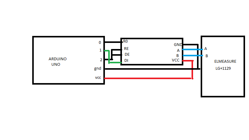

Hello everyone....
i'm newbie to arduino
i'm having an ELMEASURE LG+1129 meter , i have been trying for several days to read the register values..
My Hardware: Arduino uno, RS-485
My Firmware: Arduino ide 1.8.3, simplemodbusmaster v2rev2 DUE
Can you please guide me how to read the register value from the ELMEASURE using arduino uno
My library:
https://drive.google.com/drive/folders/0B0B286tJkafVYnBhNGo4N3poQ2c
below here attached my connection dig, elmeasure lg 1129 datasheet
Elmeasure.pdf (492 KB)
