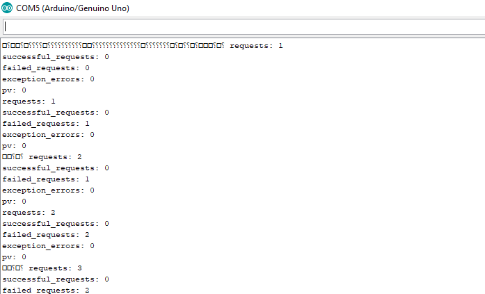

Hello,
I want to read data from a DC 1040 PID Controller, with my Arduino and I am using RS485-TTL module . I'am using a simple modbus master library it's default communication is :
Protocol: MOdBUS RTU
Baud Rate: 38400
Parity: ODD
Stop Bits: 1
Data Bits: 8
I want to read PV Value which is register 138.
this is my code....

The following attachment include connection made, datasheet, comm regs mapping,output
DC1040.pdf (855 KB)
COMMUNICATION MANUAL.pdf (380 KB)
just as a quick tipp: in the manual page 27 you find
PV
Process Value
008A 138 03H -1999~9999
on page
03 (03H) Reading multiple registers value from slave controller
in the pdf of the library you will find following information:
Function 4 - READ_INPUT_REGISTERS 4 // Reads the binary contents of input registers (3X references) in
the slave. Not writable.
therefore I guess your modbus_construct is wrong.
I change the construct in my code ...

Still no output.......
please correct me.

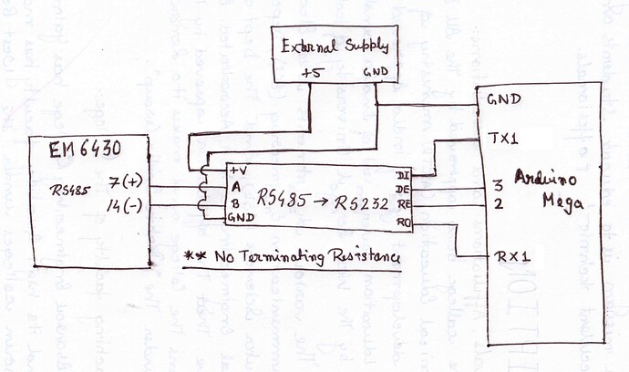

Hello All,
I am facing trouble with interfacing Selec Panel Meter MFM376C with RS485 Modbus. Somebody please help me out.
Microcontroller - Arduino Mega 2560
Panel Meter - MFM376C
Library - SimpleModbusMaster V2.2
Connections are done like -
Set the slave device as per mentioned configuration
Panel Meter - Selec MFM376C
Baud Rate - 19200
Bits,Parity,Stop bits - 8N1 (8Bits, No Parity, Stop bit 1)
Slave ID - 5
RS485 Pin - 7 +Ve, 14 -Ve
Conversion Module
RS485 to RS232 Conversion Module
VCC - External Stable Power 5V DC
GND - Common with all circuit
A - Connected to 7 MFM376C (+Ve)
B - Connected to 14 MFM376C (-Ve)
DI - Arduino TX1 Pin
RO - Arduino RX1 Pin
DE - RO - Connected together attached to one digital pin of Arduino 22
The code -

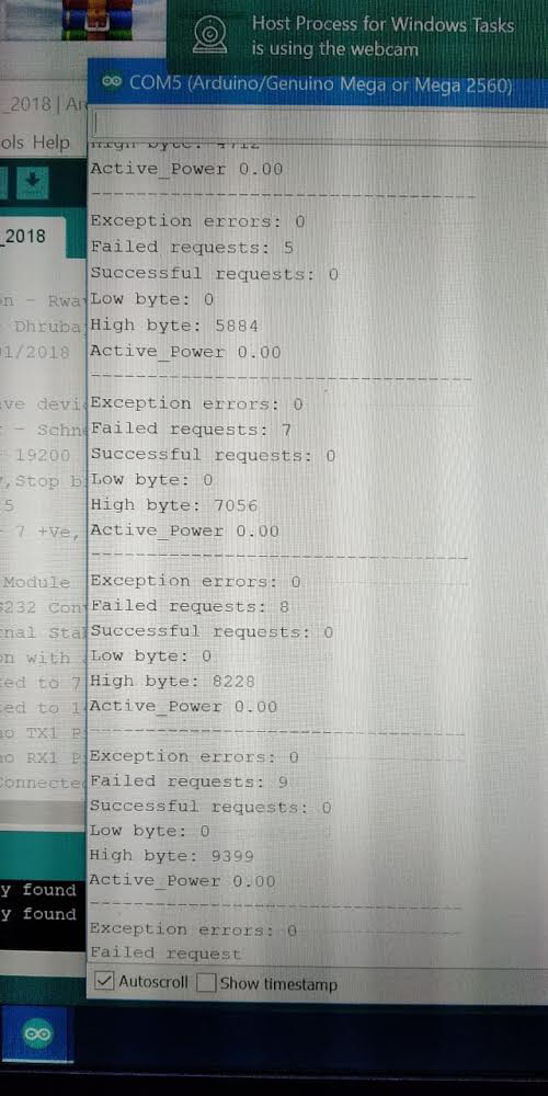

Now I am frustated trying all the options, please please please help me out.
a)
please check twice:
to the MEGA?
to the RS485 module ?
to your slave device ?
to your external Power device ?
b)
What result do you get on the Serial Monitor?

Apologies I mentioned a wrong panel meter, actual meter that I have connected is EM6430. Datasheet is available in the below link
I have made all the ground terminals common except the slave device, because it’s a electrical panel meter and I donot have a separate ground for it.
Can you please explain how do I make ground common with the panel meter. If it is actually needed?
In the serial terminal I see that failed requests increases and the high byte value also increases and then it overflows. Attached error pic.
I could read the values using my USB to RS485 module in pc via demo software, I checked the resistance across A&B of the usb module it shows nothing in this case but when
I checked the resistance across the A&B of the RS485 to RS232 module it shows 120Ohms. Can this be a reason?
Can you check if I have mentioned the address correctly or it should be some different formats.
if the panel doesn't have ground on RS485, just use two wire connection A&B. If it is missing you can't connect the ground - in this particular case it should be ok.

Thanks Noiasca,
The Serial Monitor Output after making the following changes as you suggested:
MODBUS Testing
Exception errors: 0
Failed requests: 4
Successful requests: 0
Low byte: 0
High byte: 0
Active_Power 0.00
Exception errors: 0
Failed requests: 8
Low byte: 0
High byte: 0
Active_Power 0.00
Exception errors: 0
Failed requests: 10
Low byte: 0
High byte: 0
Active_Power 0.00
Note: External Power Supply, RS485 Module and Arduino Mega has common ground.

a) I see in your new code
digitalWrite(MAX485_RE_NEG, 0);
digitalWrite(MAX485_DE, 0);
Based on the drawing you made it's clear for me why simplemodbus is not working. Simplemodbus handles only one enable PIN. So if you want to use simplemmodbus, you have to connect DE/RE to one PIN (by the way this is for me anyway the preferable way then handle two pins in the same time).
b) check the datasheet. Register 3900 + 15 for frequency is definied as float. So you will need to read 2 (or 4) bytes and 3915/3916/3917/3918 and combine them to a proper value. I don't understand why the manual sometimes says 2 bytes. For me float is 4 bytes. Even the Intervall between some values are 2 byte, some are 4bytes, so what ever the manufacturer thought how to encode this values - good luck :wink:
