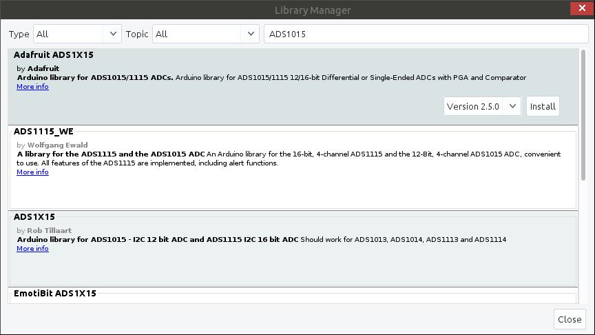

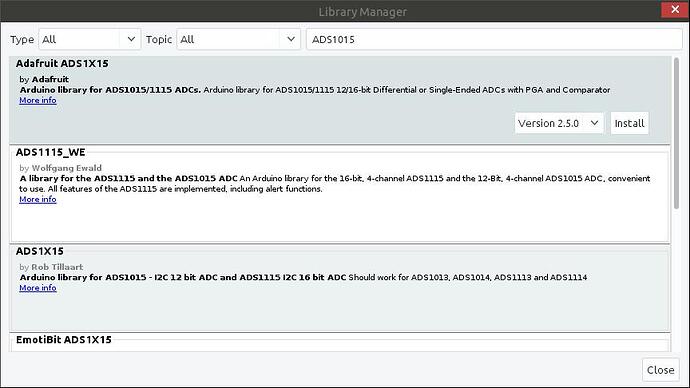

Help with my first code upload. Compilation error: Adafruit_ADS1015.h: No such file or directory
I got this code off someone for a o2 analyser using a nano.
Plenty of others have uploaded successfully but i get this error all the time. All libraries are installed, and i even downgraded the ADS1015 to earlier versions and checked but same message.
C:\Users\Tower\Documents\Arduino\libraries\o2_analyzer\o2_analyzer.ino:66:10: fatal error: Adafruit_ADS1015.h: No such file or directory
 #include <Adafruit_ADS1015.h>
compilation terminated.
exit status 1
Welcome to the forum
Please post the full sketch that you are trying to compile, using code tags when you do
This is the easiest way to tidy up the code and add the code tags
Start by tidying up your code by using Tools/Auto Format in the IDE to make it easier to read. Then use Edit/Copy for Forum and paste what was copied in a new reply. Code tags will have been added to the code to make it easy to read in the forum thus making it easier to provide help.
From the error message it is obvious that the compiler cannot find the Adafruit_ADS1015.h file. How exactly did you install the Adafruit_ADS1015 library ?
I installed them through Sketch - include libraries - manage libraries then found and installed

From the Sketch menu, > Include Library > Manage Libraries, in the text input box i typed in "ADS1015", selected the latest version, then clicked on the Install button

If you installed GitHub - adafruit/Adafruit_ADS1X15: Driver for TI's ADS1015: 12-bit Differential or Single-Ended ADC with PGA and Comparator (the first one in below screenshot), the include is #include Adafruit_ADS1X15.h; see the examples.
If you installed another one, tell us which one.
Check the location of your Sketchbook folder in File/Preferences in the IDE. In the Sketchbook folder there should be a folder named libraries
In the libraries folder is there a folder named Adafruit_ADS1X15 ? If so then please list the files and folders within it
From the error message it seems to me that the sketch is trying to #include Adafruit_ADS1015.h instead of Adafruit_ADS1X15.h
Try changing the name of the file that it #includes
No, that's the one installed
