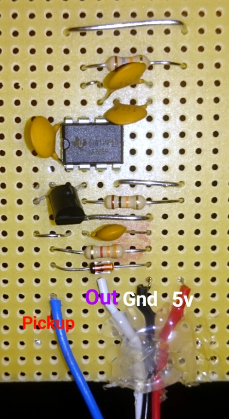

So, I built the circuit but I'm not getting it to work.
I had wired the bt149 backwards, and thought that was the problem, but guess not.
Questions:
  1. Can the backwards wired thyristor have caused any damage to itself or the 555?
  2. My pickup wire is about 4m long shielded microphone cable - too long?
I tried with and without the shield connected to arduino ground, no difference.
I tried both twisting the wire(shield and outer insulation stripped off)around the ignition lead and using a metal clamp.
I've gone trough the circuit multiple times to check for errors, can't find anything wrong.
Here's a picture of my board. Vertical copper strips, cut under the 555 otherwise untouched, no jumpers on the underside.
Anything obviously wrong?
I can see pin1 of the LM555 and the cathode of the SCR connected together, but not connected to gnd.
Do you have a DMM to measure electrical parameters?
Tom.... :slight_smile:
PS, I would advocate IC Sockets in first try/prototype circuits.
Thanks for the reply!
There is a jumper from pin 1 to ground, I bent the bt149 to show where it's pins are connected, the end of the jumper is hiding under it.
Yep, got a multimeter.
You are right, I'll order some sockets!
Have you got the gnd of the circuit connected to the gnd of the arduino?
Also if you jumper the gate of the SCR to the 5V positive, it should trigger the SCR.
Use your DMM to see if pin2 of LM555 goes to gnd when you connect gate to 5V.
