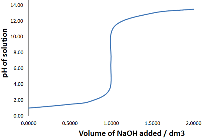

The pH is a value between 0 (acid) and 14 (basic) with a neutral value of 7.
The curve (log10) of the pH is a mix between linear and exponential as you can see in pH_curve.png. It means that you can almost measure a linear value between 4 and 9 pH. Less than 2 and more than 12 is almost impossible to determine something (too acid or too basic).
