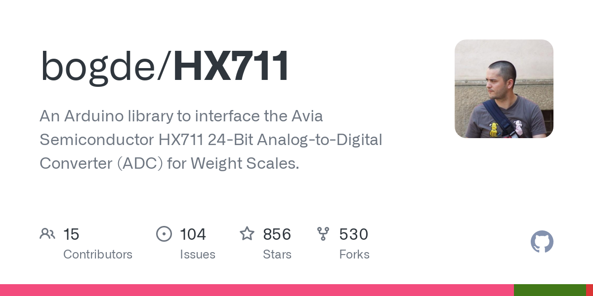

HX711 library in github for arduino..

Yes, I was able to get readings from my project. Jonte987 was correct, The MD-PS002 is a millivolt wheatstone bridge. In order to read it, you will need to use a weighing sensor amplifier. I used the following links:
HX711 Spec Sheet:
GitHub Library and Example Code:
The example code is for a weight scale and not for a pressure sensor. Both weight scales and this pressure sensor use wheatstone bridges and both send out readings in millivolts. I used the weight scale example to check my MD-PS002. I will be working on calibrating the output from grams to mPa. Beyond that I will be working on multiple vacuum pressure sensors with multiple HX711 breakout boards.

I use HX711 with my PS002 vacuum sensor and have no problem. When You use HX711 You should connect HX711 E+ pin to PS002 +IN pin; E- to both -IN; A+ to +OUT; A- to -OUT. You will have 4 wires from PS002 because both -IN to connected together.
You should install HX711 library and then You can use standard HX711 sketch from examples. If You will set 64 scale in the sketch You will take vacuum pressure in pascals. Full vacuum will show You -100 000 pascals.
I was able to operate the sensor using HX711 module but I´m getting incremental values, I mean, read_average(byte n) function is returning higher and higher values after system restarts so tare(byte n) is impractical this way.
