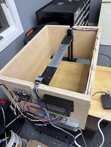

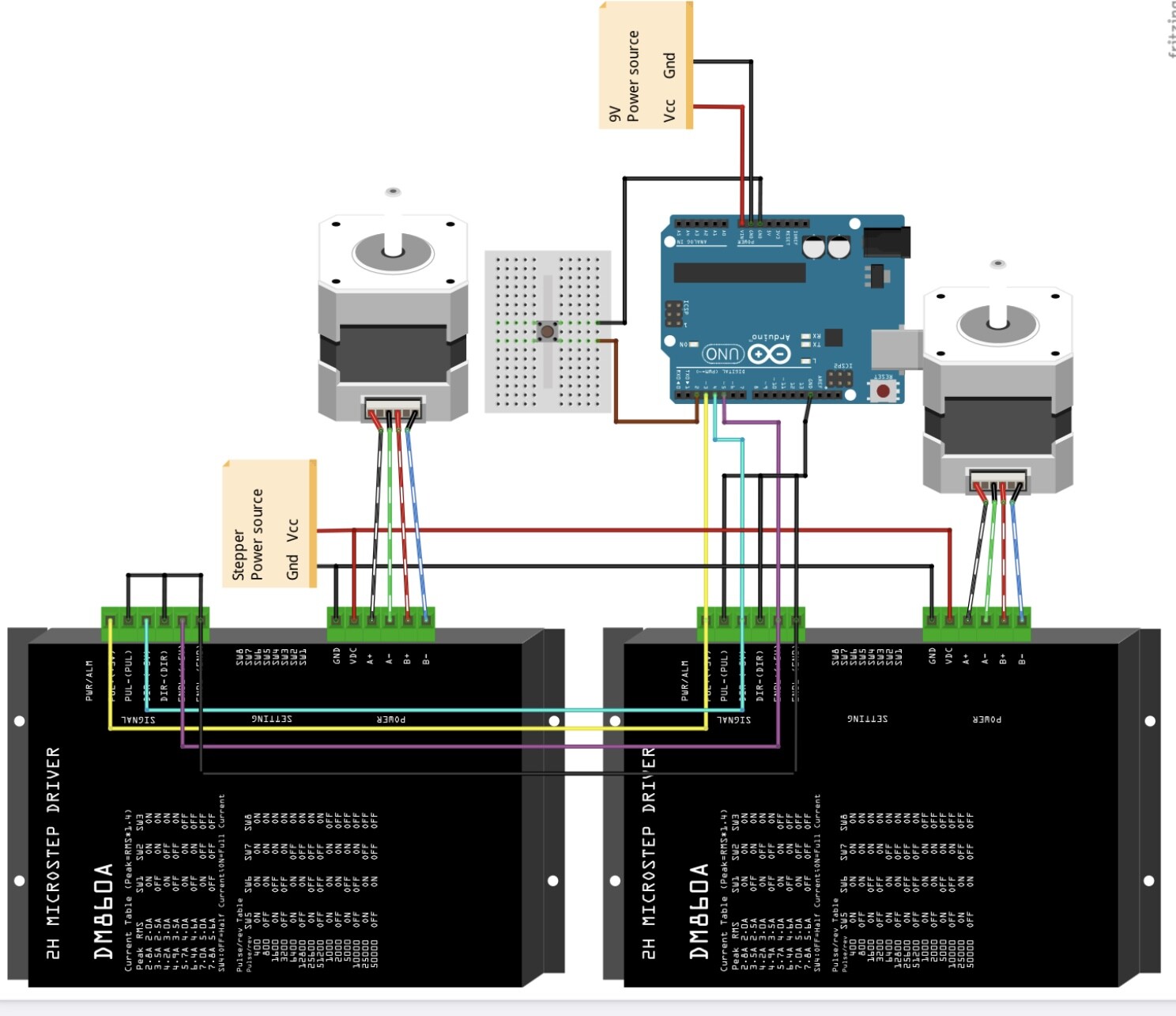

Hello Guys I am new here and with Arduino, I am working on my home teather system and I did built a case with 2 Nema 11 Linear motors and 2 MB6600 as a controlles , One of my friend tried to code for me since I don't know how to code, I just need a simple coding that makes my motor
goes up and down so the projector can go inside the ceiling and a regular switch on and off , my project right now motors sometimes goe very noise they dont go in stand by when they are not using so they stand by overheating and also motors can't identify it limits when its up or down position, if anyone can help it will be very appreciated I will post some pics

How do You make sure that the 2 steppers are at the same level? If one has been missing steps there will be a mechanical lock.
I suggest increasing the second delay, in the foor loop to 10000. The pulsrate might be to high and steps might be lost.
A library providing acceleration might be needed for "full speed".
You can surely reduce the button debounce delay to 50 but it's not the reason for the trouble.
When it runs we can look at the limit switches.
