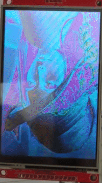

I'm having some issues rendering jpg images saved as hex at the flash memory.
The images present some glitches.
At the beggining I thougth it could be the image conversion but all the files of the TFT_flash_jpeg example presented the same gliteches an color distortion.
Other issue that's making me crazy is that when I work with tft.invertDisplay(0); my tft.fillscreen(tft_WHITE) makes the screen goes light green, but if I invert the display and fillscren(tft_BLACK) it turns a clear white screen...
gif
I'm using an ESP32 (Wemos Lolin 32 version) with the following display: Display 4.0" SPI
Touch SKU MSP4022 ili9486 3,3v-5v 320X480 RGB 65K
Attached is my User_setup.h and my User_setup_Select.h
User_Setup.h (15,8,KB)
User_Setup_Select.h (11,1,KB)
First off. Run all of the library examples. Make sure that your colours and touch screen is working correctly.
The JPEG "feature" may need you to use tft.setSwapBytes(true);
From TFT_eSPI.h
  // Image rendering
           // Swap the byte order for pushImage() and pushPixels() - corrects endianness
  void     setSwapBytes(bool swap);
  bool     getSwapBytes(void);
David.
Thank you for the fast answer David!
I already run all the library examples.
My touch screen is working well, but the color not much...
As I said, when I'm at the normal mode color (tft.invertDisplay(false)) my White color show something like light green, and all the other colors seens to have a little more green too.
If I invert the display, the colors match perfectly with the negative... Like if I do fillscreen(BLACK) the screen goes a perfect white, and if I do fillscreen(WHITE) it goes black
Can someone help me with this, please?
