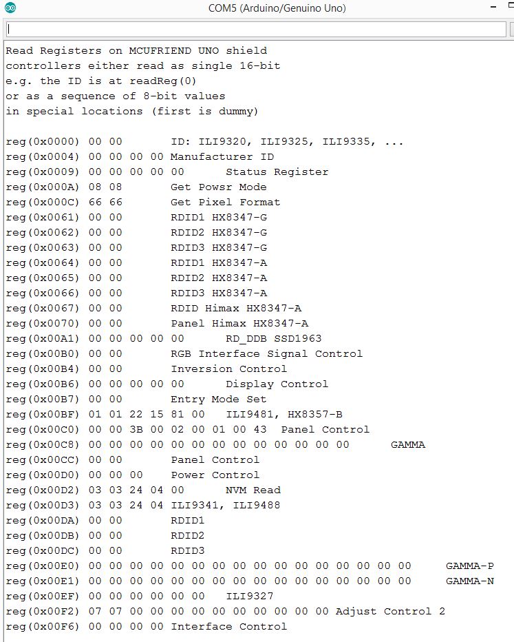

I try the example "GLUE_Demo_480x320" with UNO and MEGA. and works fine.
When I try example "LCD_ID_readreg" I receive in serial monitor what you can see in pic. attached.
I do not know which driver it works.
You have a Renesas R61581 controller with ID=0x1581
Probably with a 320x480 display Panel.
So every photo on your Ebay link is untrue. (except for the left hand side of photo #1)
Most of the example sketches will report the ID on the Serial Terminal.
David
