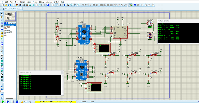

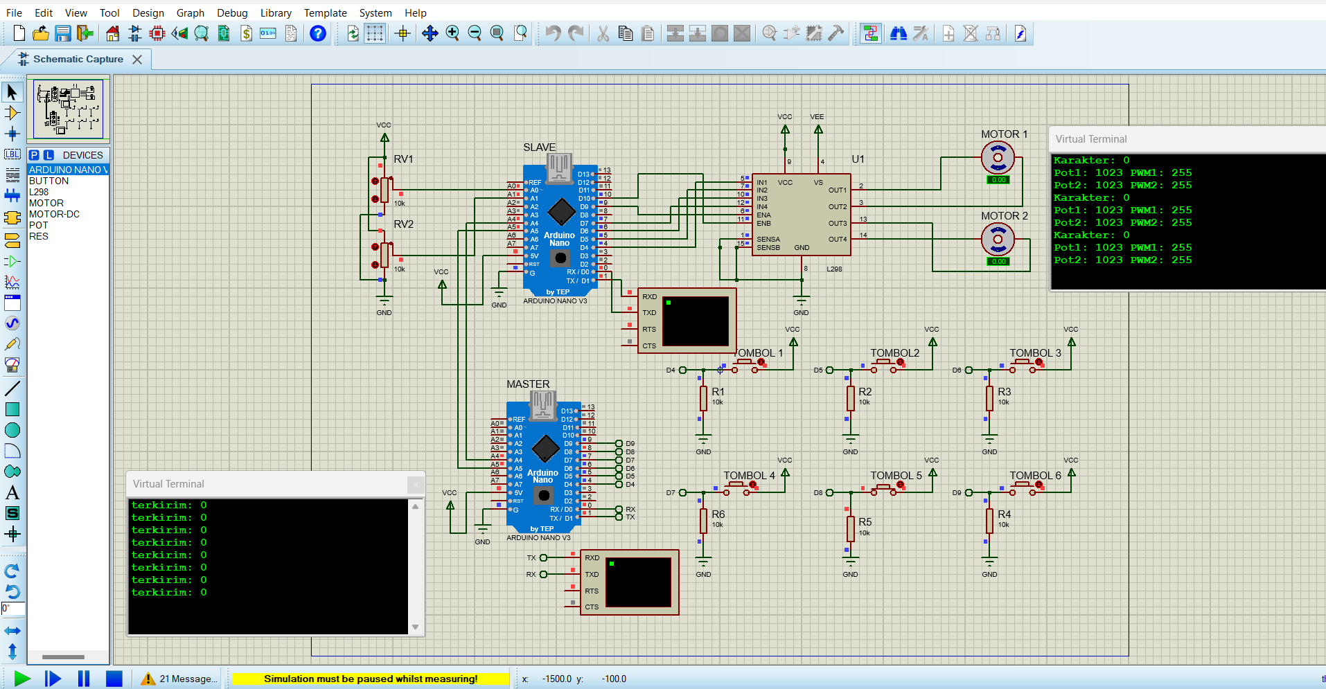

ok so i tried to make this project with code that was made from manipulating register instead of using (digitalWrite, digitalRead, AnalogRead, etc.) due to my teachers rules.
so i tried wrote the code for both master and slave (it's using I2C as serial communication that sends data (1-6) from master to slave in order to determine which motor direction will move in slave part), i'm using arduino nano for this project, but i encountered this problem (data that sends from master's part keep sending '0' even though i'm using interrupt service routine (ISR)).
here's the code that i wrote, i hope someone could help me out of this, thanks in advance!

need to isolate the problem
have you verified the code to send msgs from master to slave?
have you verify the code to control the motor?
if (PIND & 0b00010000 ){
and so on
  if (data > 0) {
    // Mengirim data melalui I2C jika tombol ditekan
    Wire.beginTransmission(SLAVE_ADDRESS);
    Wire.write(data);
    Wire.endTransmission();
    Serial.print("terkirim: ");
    Serial.println(data); // For debugging
    data = 0;
    delay(50);
