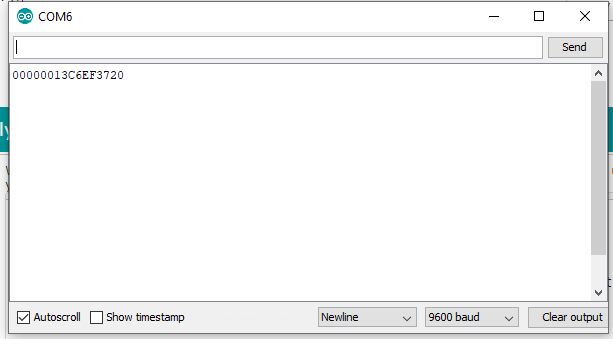

I want to know why when I Serial print below code I am not getting the whole result:
EX: 0x9e3779b9*32 = 0x13C6EF3720 but I am only getting 0xC6EF3720 which is missing the 9bit
uint32_t sum = 0x9e3779b9*32;
Serial.println(sum ,HEX);

The multiplication results exceeds the the highest number that can be represented by a 32-bit integer.
Also,
The multiplication is only being done with 32-bit arithmetic.

The Serial Monitor shows:
Try different numbers that have leading zeros in data.myData[1] and data.myData[0] meaning the 16 bit value is less than 0x1000. It's not a very good solution if it only works for some numbers.
How about this one?
  union
    uint64_t x;
    uint8_t myData[8];
  } data;
  data.x = (uint64_t) 0x9e3779b9 * 32; //0x13C6EF3720
  for(int i=7; i>=0; i--)
    byte x = data.myData[i];
    if(x <0x10)
      Serial.print('0');
    Serial.print(x, HEX);
  Serial.println();

The sketch of Post#6 is now checking leading 0 of every byte of the result. Therefore, the print() method would show the leading 0s.
Tested for:
0x0102*0x0102 = 0x10404
How to discard all those meaningless and odd looking 0s that are appearing at the very left of the result?
Don't print anything until you find the first non-zero byte. Then print all bytes (with added leading zeros as necessary).
