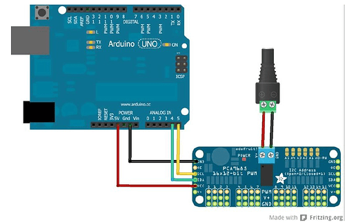

Here is how I connected it
Imgur
Put the wrong link in the "insert a image", havn't been posting too much on this forum
The power should not be the problem, as it is getting power the same way as the rest of the legs which does not have this issue.
Its like the pwm signals from the arduino is somehow being distrupted by the communication between the arduino and the pwm board. No idea wether this is a code issue or hardware issue.

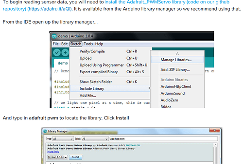

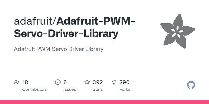

This is the library:
Which you can get in the arduino app:
