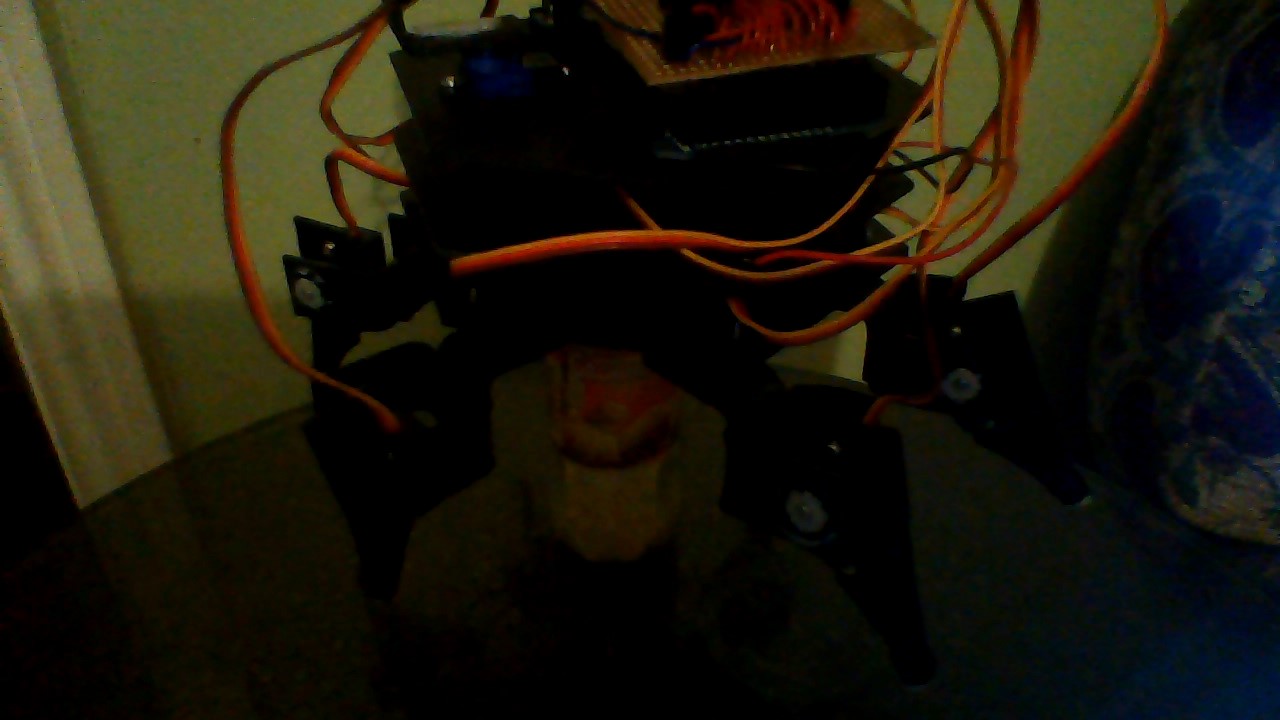

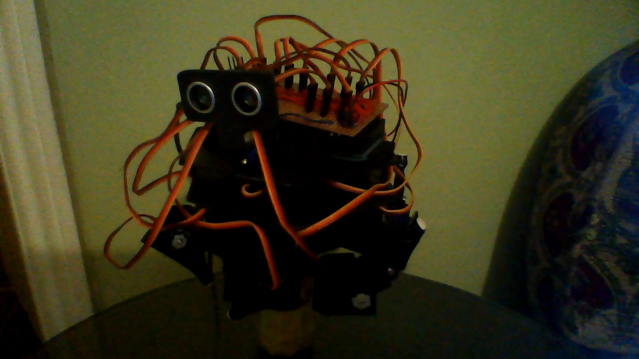

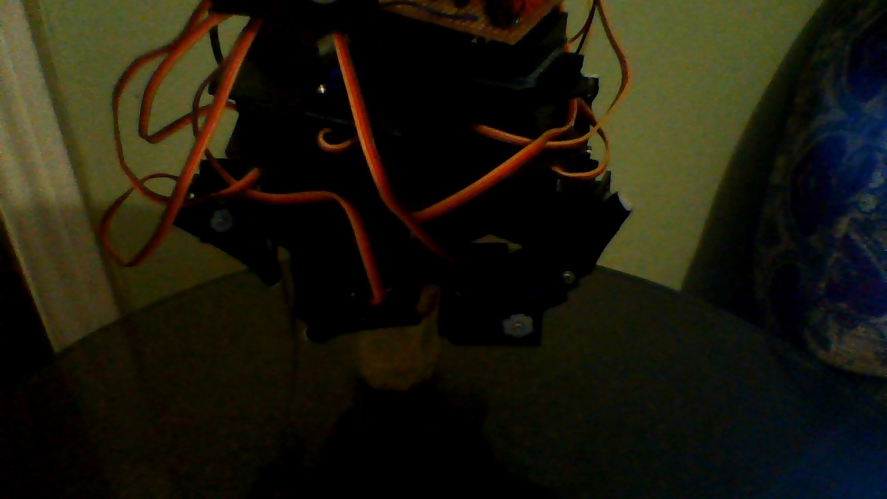

I have built a simple hexapod.When I turn on my hexapod insted of running the code all the legs move and
get jammed.This happens no matter what code I run and the legs always get jammed in the same postion. The servos are being run by 4 aa batterys.The ground of the batteries and the arduino ground are conected .The arduino is conected to my computer.When the legs get jammed the servos are still running.On rare occasions it might work but then next time i upload to the board or unplug and then reconnect the arduino or unplug the power and plug it back in the problem persists. Any ideas on how to get it to stop getting jammed.
I have attached two pictures of the legs jammed and one of the legs in a normal postion.

You probably have insufficient power supply

Perhaps it is a different bad assumption you have made. Just how many servos are you trying to power using 4 AA batteries?
only 3 at one time and when the legs get jammed they move themself at the same time.
The video attached shows the problem.No matter what code I upload this happens and it ignores the code I have uploaded.It just stays tangled like that and never runs the code. How do I fix this.
sorry for the poor video quality.
DLKcreations:
it ignores the code I have uploaded...... and never runs the code
How do you know that?
You need to put some serial prints in your code, and I'll bet that if you print a "hello world" message in setup(), that it will display.

The code has passed scrutiny by some of the Elite members ...so perhaps it's time to take their advice and look somewhere else for the fault/error?
Is your wiring done like this?
ALL the servo positives/red on one rail ( connected together ) and wired directly to the battery pack positive.
ALL the servo negatives/brown on one rail ( connected together ) and wired to the battery pack negative/GND.
The battery pack negative/GND is connected to the Arduino negative/GND.
The individual yellow/orange signal wires go to the Arduino pins.
First off - these are standard servos, right? Not "continuous rotation"? Verify that first.
Assuming the above then, before you assembled your hexapod, did you "center" or otherwise align the servos (according to kit instructions, if you are assembling a kit) before you attached them to the joints?
Think of it this way - a servo, when it is powered on (and no signal), will move to it's "0 degree" position:
https://www.servocity.com/html/how_do_servos_work_.html#.VHdkBlXd9iE
The servos would need to be attached to the joints with this in mind (or the servos would need to be positioned to whatever angle is needed - maybe 90 degrees - using a servo tester or some other method) - otherwise, when you power up the system (and/or give the servos signals), the legs will just bunch up or whatnot because the system is expecting the legs to be in a different position than the servos were connected...
I hope this makes sense; it's not easy to describe...
The wires are connected as woodygb has described i have run the code and the servos all seem to be working fine.I am just about to try cr0shs idea and centre the servos.The servos 180 degree servos.
I have centered the servos now so they dont get jammed.It seems that if 4 servos are defined in the code the servos work but if 13 servos are defined in the code,the hexapod servos stay at 0 degrees and make a buzzing sound and if i send a command to the hexapod it just all stays at 0 and contines buzzing. As I said if only 4 servos are defined in the code it works fine and i dont know why this happens.Even if i do have 13 servos defined i never move more than 3 at one time.
What is the measured voltage (using a multimeter) being supplied to the servos when you are trying to move several? Trying to move several servos may be killing your batteries.
just read the voltage i got 5.72 i always check im getting more than 5v from my batteries if im not i swap them out.
Just to be sure, that measurement was taken while four or more of the servos were trying to move (aka batteries under load)? note that radio shack type battery holders may have some significant wiring/battery contact resistance that may cause issues when under load.
