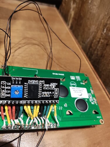

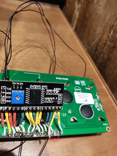

High contrast lcd not working
Yes they are correct
Digital MultiMeter (DMM).
Yep no solder bridges
One more thing my i2c board doesn't have a jumper here should I bridge it?
If your wires are just popping off, none of them are reliable. To make them reliable, all the wires need to be:
  1. Labeled
  2. De-soldered
  3. Cleaned
  4. Re-soldered
  5. Continuity verified
