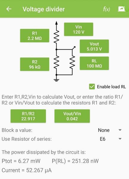

hello all,
i got wrong reading when read voltage to analog input with high impadance resistor divider, i'm using a million ohm resistor for make it 5v to analog input, it's because of my reading is dc high voltage, it's about 120Vdc.
i read at this forums, arduino analog input is only recomended for <10K Ohm resistor divider impedance, if bigger than that then its cause wrong reading...
what i read at this forum, the solution for high impedance is using buffer with an Op Amp in a voltage follower configuration. and i found in google, the suitable Op Amp type for voltage follower configuration to arduino is MCP6041 / 2 / 4.
my question is, if i can not find that Op Amp (MCP6041), any sugestion of other Op Amp, maybe the equivalent one?
i mean, the common Op Amp (easy find in market), like LM358 or etc but it can suitable for my case above.

The common solution is to add a 100n capacitor between analogue pin and ground.

ok, i will try it, what if adding the 1N4148 and resistor, it will works better ?
please check the picture below...
thanks.
The picture is blank for me. But no, the solution is to use the 100 nF cap, as suggested above.
A 1Meg/100nF low pass filter has a time constant of 0.1 seconds, so don't try to read the ADC faster than that.
That is ALSO adding over-voltage protection, which is not needed with a 1Megohm resistor in the divider.
Just a 100n capacitor from pin to ground is enough.
What value is the other resistor.
Are you using default Aref, or the more stable 1.1volt Aref.

To divide 120V to 5V is a ratio of ~24, implying 1M and 39k values or so, which is only 37.5k impedance
seen from the analog pin. Still thats higher than 10k so a 100nF cap is indicated in parallel with the 39k
resistor. That's got a time constant of 100n x 37k5 = 3.75ms
Extra diodes aren't useful/needed as the 1M resistor is limiting any current to 120µA max, which
isn't going to stress the protection diodes on-chip.
You can use two 560k resistors in series in place of the 1M for extra safety.

if i use voltage divider resistor 2.2MΩ and 96KΩ, then i use cap 100nF for the filter, so the time constant became how much ? 0.2 sec ? if it yes 0.2 sec, then what i must do at my coding, should adding the delay 200ms ?

my resistor divider is 2.2MΩ and 96KΩ.
yes, i'm using default Aref, but i'm planning to using TL431 for external reference.

ok, i see, if i use 2.2MΩ and 96KΩ for voltage divider,
then for the 2.2MΩ, better i use more resistor in series for making itu 2.2MΩ, i.e. 1MΩ + 1MΩ + 100KΩ + 100kΩ so the total is 2.2MΩ.

see, if i use 2.2MΩ in series with 96KΩ for voltage divider,
