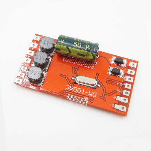

Maybe you can modify some LED driver like the "3w 12v led driver" or the "300ma dmx512 decoder board" and connect it to a PWM controller (like the PCA9685)
