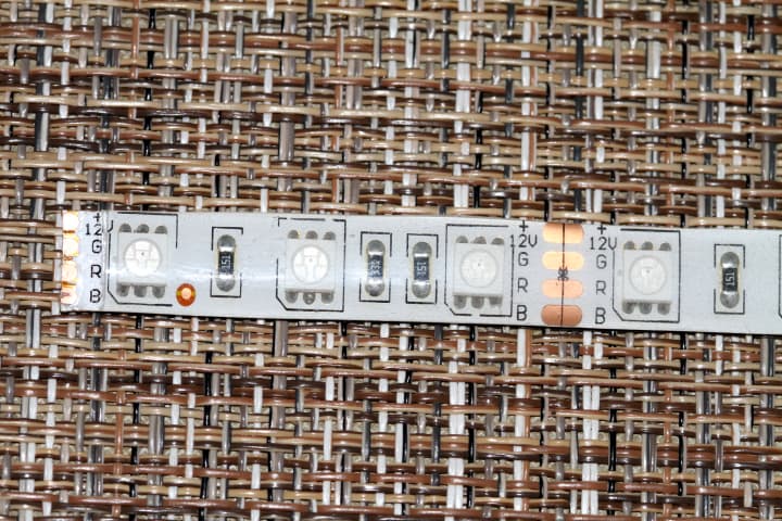

OK just a little clarification. Earlier as an example I posted this image:
The reason you see 3 each of RG and B LEDs is becaude it is an example of a small strip of RGB LEDs.
In this image each LED is a tri color LED RG and B and they are simply shown as groups of three LEDs in series with a current limiting reaistor. The strip can be sut to length.

Very helpful. The strip LEDs have series resistors between each 5050 LED.

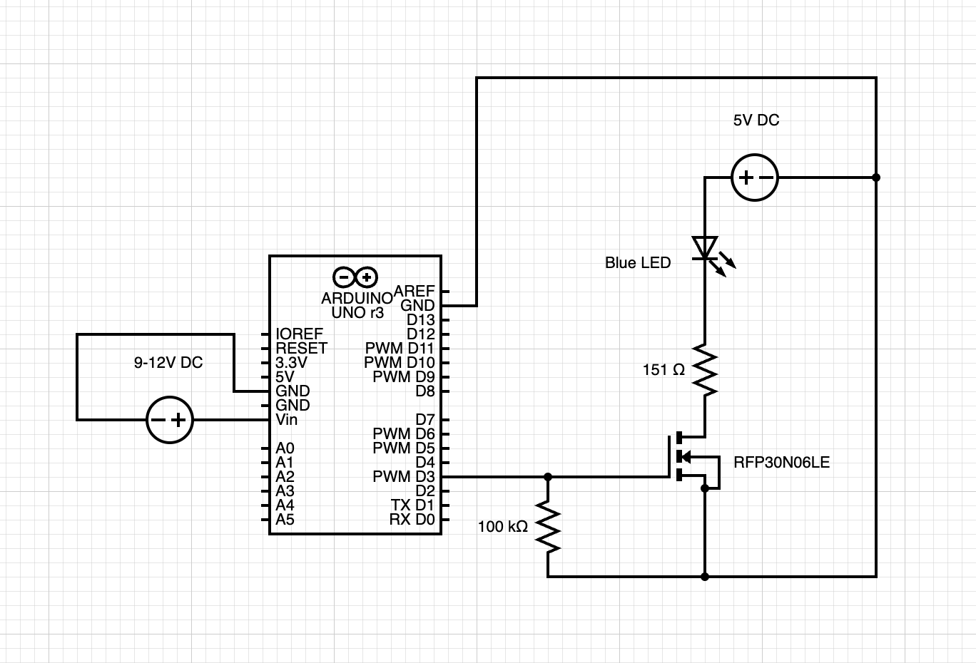

Based on your circuit drawing, I can hook up the FQP30N06 to the LED anode directly to the drain with a 331R or a 151R (depending on color) and connect the source to ground. The gate gets a 100k resistor to the GPIO pin. This also goes to ground?
I attached a drawing of how I believe the circuit should be set up. Is this correct?
Somehow I missed this, sorry about that. Yes that will work. May want to add a 1K resistor in series with the gate in addition to the 100 K to Ground.
