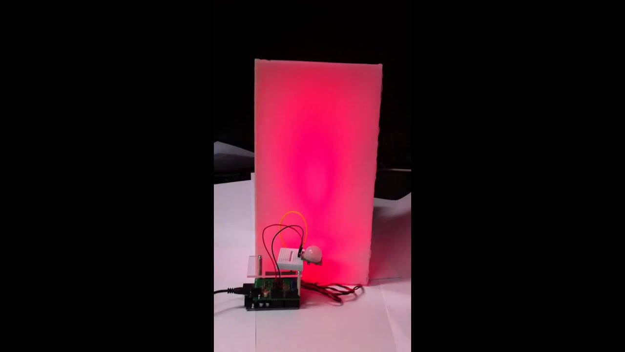

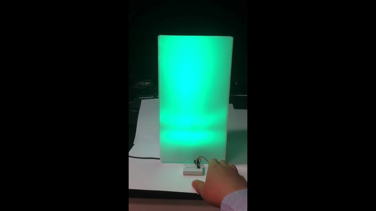

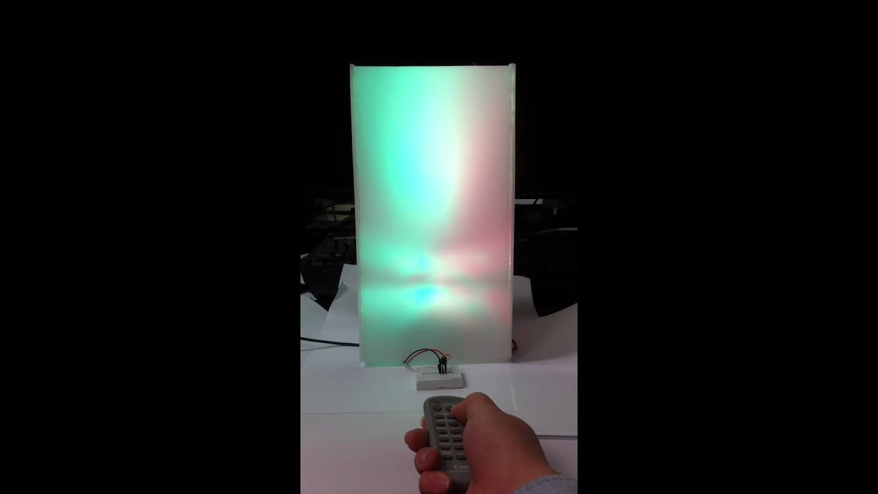

the final design of the LED driver handles LEDs pretty well. It has good current regulation, wide operation frequency, modest heat dissipation, low current ripples.
