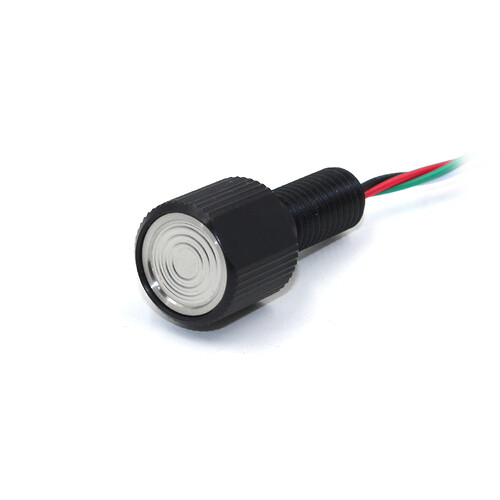

These type of sensors come in a range up to 10MPa (100 bar).
They can work with any 5volt logic Arduino.
The 1.2Mpa (12bar) sensor seems popular.
