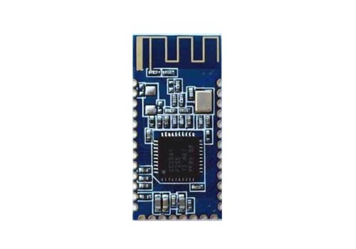

I am using an HM-10 for the first time I purchased from DSD TECH. I am going to use this module to control halloween decorations from a central server build on a Raspberry Pi.
Does anybody have any good tutorials on using the DSD TECH HM-10 with an arduino? I am writing the test code on an UNO, but will be migrating to a Nano for implementation.
So far the only application that I have been able to make work is the demo application. WIndows is unable to see the HM-10 when I scan for bluetooth, and any AT commands seem to require a reboot of the chip. I would like to be able to set the AT commands in the setup() function.
Any help would be appreciated.

You mean this code?

That is all normal. HM-10 is a BLE device and is in AT mode by default on start up. You can thereby send AT commands in setup until you send a standard serial command. Any further AT commands after that require a reboot.
I believe you should see it OK in windows, but you don't need to pair with it. You may need a proper BLE terminal programme. Check the Martyn Currey website.
