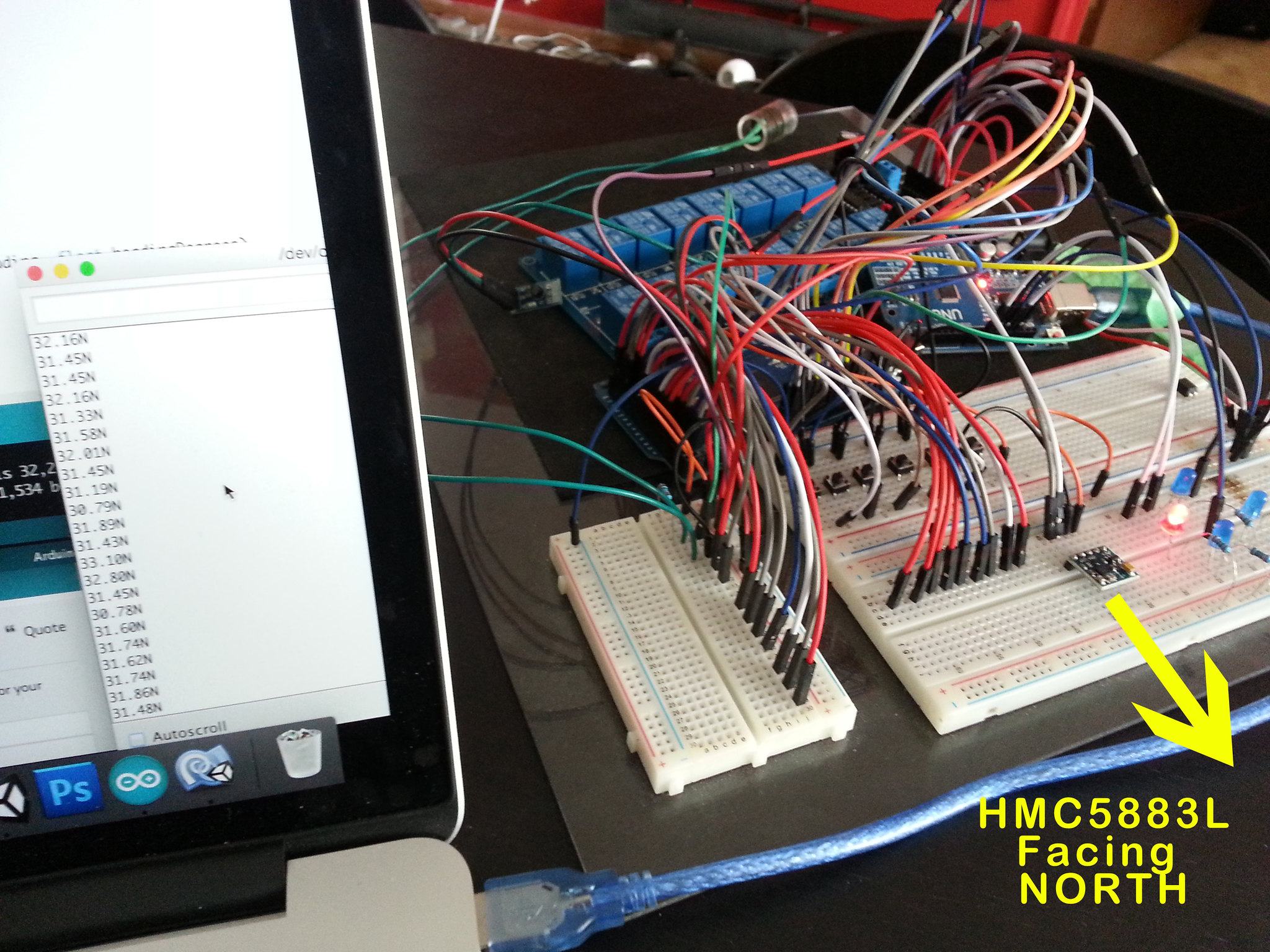

Hello I found this great code online for the HMC5883L Digital compass. Basically I am just wanting to write 4 characters to the serial port when the compass faces in any of the desired directions.
Something like this:
CompasCharactersToSend by Michael Knight, on Flickr
I made a slight change to the Arduino code so I think I am kind of the right track with what I need but could use a little help from someone a lot more code savvy :wink:

Yes the sketch was printing out direction info to the Serial monitor as expected which is great.
I'm using an Arduino Uno R3 right now just to get the code working right, ultimately though it will be put onto the Arduino Mega I'm using for the test of my project.
So the compass seems to be working fine.

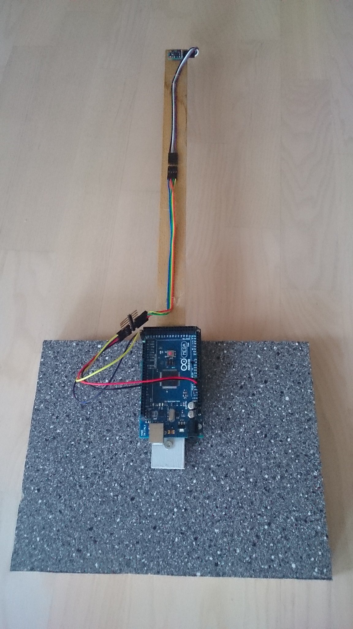

In order to work properly, magnetometers MUST be calibrated and kept away from magnets or magnetic materials. Here is an overview of the process and here is one calibration procedure for your compass.

I'm on a Mac and not very good with a lot of the code stuff, I tried downloading the header thing but it just gave me some errors.?
Is there a way to calibrate the sensor on a Mac?
Perhaps. You need to be able to read the raw data and from that, calculate an offset and scale factor for each axis.

I threw in the example code and I get this in the serial monitor:
With the module mounted on the breadboard the markings indicate (According to a real Compass) that the:
Y axis is facing towards the East
X axis is facing towards the West
not sure if that helps any?

But I'm not sure I am using the values correctly:
float declinationAngle = +3.70;
Also which direction should the board be facing to point North? I keep thinking the "Y" marked on the board indicates the forward facing direction of the board??

Well it's kind of hard to say because I have two things I keep trying to get a straight answer on.
  1. which way should the board be facing to indicate it's reading.
  2. am I doing this part of the code correctly.... this 2nd one is the reason I "Cross Posted" as I felt that was more programming related? Was I incorrect in that assessment?

I'm using this code as (And I'm just taking a guess here that the ----->Y marking on the board signifies the forward or front of the board that would correspond to the LED's that light up when the board faces in that direction)

20160325_122157 by Michael Knight, on Flickr
So it's partially working although when I rotate it in other directions the readings are a little off which I can only assume are because I have this wrong:
I don't have the same board. This is something you need to figure out and understand. Read the data sheet for the compass, look at the code and experiment.

Try remove your 5883L chip away from the laptop, and at least 50cm away from any metal.
You should build a calibration stand like this (takes 2 min)
Imgur
Then turn it clockwise in calibration mode.
The code could be a simple one like this :

This was working for me the first time i used it.
The code is small and simple, and it's easy to implement it in your own code.
