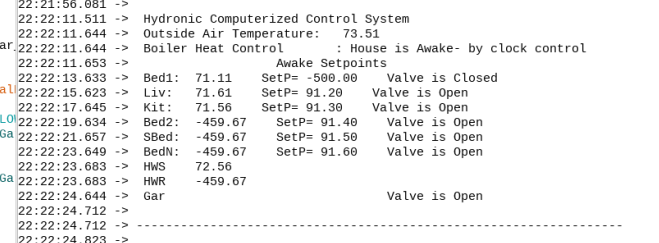

Here is my 99% finished code. I used Bob’s array suggestion where I could.
The Arduino Nano does almost all the work. It gets a single 3v signal (with resistors for safety) from a Raspberry Pi 4 GPIO output for occupied/unoccupied schedule. I have 8 zone valves with 6 on-slab thermistor floor sensors and the garage zone under tagalong control with another zone. The laundry valve is not used.
Valves and automation including panel and relays etc are up and running on my bench for two weeks now. Installation in the 3500 sq ft house will be in August. Project is far away and I am in NC. I have total control from any place in the world via VNC for $0 cost per month since VNC allows up to 5 remote sites for free.
To change set points I VNC into the RPi4 and use the headless desktop to modify my Arduino sketch in the IDE and then upload to change set points and save the sketch. I also can modify the time clock lines of code to be auto (via RPi4) or ON or OFF. I can monitor all the temperatures using the serial monitor feature of the Arduino IDE. I used all 8 analog inputs by adding HWSupply temp and HWReturn temp using thermistors. I needed one temperarature more for outside air, so I used a DS18B20 into one of the Arduino Nano digital inputs.
I used a 5 volt relay strip of 8 relays to interface the outputs to the valves. A separate independent panel (Honeywell R8888, qty 2) gets signals from my relays and controls the boiler on and off.
The Arduino just keeps on plugging along even after a power interruption. The RPi4 needed a crontab -e program to initiate the time lock python (Thonny) program after a reboot, and my python program picks up the time from the internet on reboot and sets time clock occupancy correctly.
I am proud of what I have done so far. I am also open to suggestions from anyone. I seem to have no bugs. All works well with the actual finished and wired panel and actual physical valves. If any pictures are requested or further info needed, let me know. And thanks, Bob for array suggestion.
ps - I was not happy with the “noise” of the thermistors that made the temperature “jump” as much as 1 degree up and down in milliseconds. Not sure why, I don’t suspect electronic noise. I suspect calculation noise of the complicated log math used for the non-linear thermistors. So, I sampled each reading from each thermistor 20 times over two seconds and averaged the 20 readings.
Btw, I can copy any amount of serial monitor temperature readings and by using spreadsheet data sort commands and the spreadsheet graph function, I can produce temperature graphs for hours or days.

  1. List item
serial monitor via headless with VNC
all sensors are not in place in my test bench setup and setpoints are in test values
here is the Thonny output text

98% finished code , subject, of course, to revision, when arrays are mastered and EEPROM used from GUI.
[code]

Serial Monitor printout/readout
Two images to place here to add visual context aid to coding. I am not trying to make this a copper pipe/hydronic thread, so I will probably post this whole project on a plumbing forum for comments about installation etc. It is only bench tested so far. Installation is in July 2022, soon.
It looks like you upgraded to a Pi4. If I were working on this, I'd like to have a little web page on the Pi to make temporary (or permanent) changes to the setpoints without having to reload the code.
But as already advised, take the time to master arrays, better yet arrays of struct. Your code will be shorter and cleaner if you can do it.
Wildbill,
You have opened up a future line of study for me on the webpage idea. Without asking you for a tutorial can you explain your statement about "permanent" setpoint changes? Isn't the only way a Sketch can be permanent is for it to be "loaded"? Can a script to the webpage take a change of setpoint, send it to the Arduino code input and then save the Sketch new code so that after a reboot the new setpoint will still be there?
Opie
Isaac
If you store the set points in EEPROM on the Nano, the Pi can send adjustments over serial and indicate whether they're to be temporary or permanent.
Wildbill,
May I get your blessing on the following link as a place to start my study of EEPROM?
https://roboticsbackend.com/how-to-save-values-on-arduino-with-eeprom/
Personally, I would start with the Arduino reference.
One thing to beware of is that the EEPROM has a finite life - you can only write on each byte ~100K times before it starts to degrade. This shouldn't matter for the purpose of changing set points, but you need to be very certain that your code isn't doing unnecessary writes - a bug can fry the EEPROM very rapidly.
