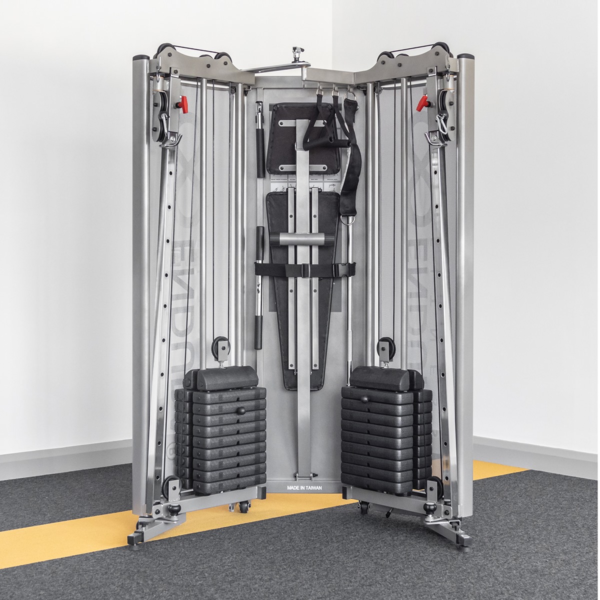

I have a cable machine in my home gym that uses regular weights for resistance.
At the moment the highest weight the machine can go to is 50kg each cable, but was hoping to up it to at least 100kg on each cable using a DC Motor for resistance something similar to speediance Gym Monster product.

You are assuming that the safety mechanisms can handle the additional load. If that’s the case, it means the machine was over designed.
this is the box gym i have at the moment, each side at the moment holds 50kg, i guess i could do with just 50kg each side and work up to see if it can hold the extra tension?
