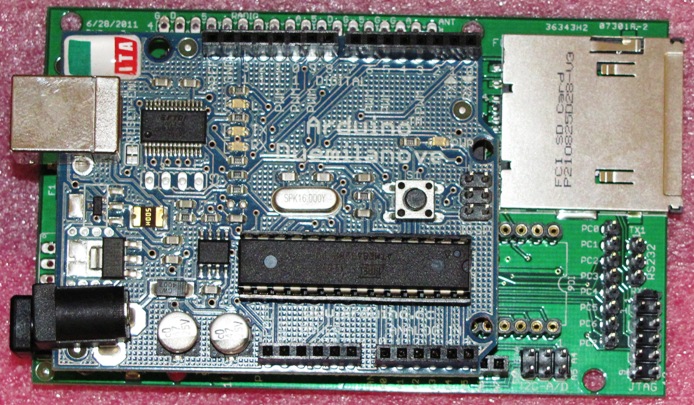

crossroads i was looking at the Bobuino rev 17, that thing is a beast!!
A beast in terms of capability & user flexibility!
Size wise, just a little bigger than an Uno.
Yeah i read through the PDf and what you get for that slight difference in size is a lot more of options. I thought the RTC and Jtag where a neat addition
I don't have any tools that can take advantage of the JTAG interface yet, but it will come on handy when I get around to writing a big sketch.
