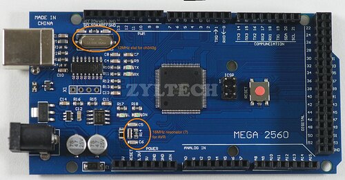

Microcontroller is atmega 2560, I got it on aliexpress. It is the kinda big crystal you see the 12.000 on it.
Also westfw I think you solved the problem because I was unaware of this. I see the 12 Mhz crystal connected to the CH340g. However now I don't know if my board has an oscillator or resonator at all.
It does, tiny little silvery thing right next to the chip ( a ceramic resonator - not readily replaceable, and likely 16mhz anyway)
Here's a picture. (A Mega Clone I found on eBay. YMMV.) Actually, it looks a little funky; usually if there is a resonator, you wouldn't need the extra caps. And I'd be happier if it were closer to the chip...
Leave it to China to populate ALL of the parts, even the ones that are supposed to be left out under some circumstances...
westfw and DrAzzy are probably right. You could be looking at the USB/Serial crystal.
The clock/crystal/resonator for the MCU is tiny, and not far away from the 3.3volt/5volt pins.
Leo..
Allright thanks, I have the same board configuration as the picture you linked. The 16 MHz crystals I ordered won't be wasted though, I will use them as external oscillators for some attinies :slight_smile:
