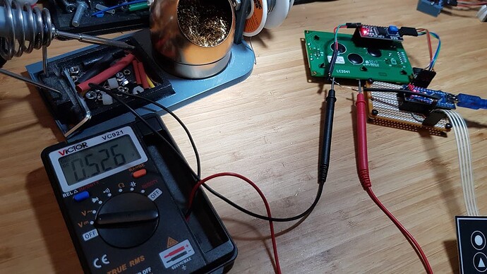

the voltage between collector and emitter is 2.1 v. (considering i have 4.65 , doesn't that mean 4.65/2.2 i'm drawing 2.2 amps?
What value is your series resistor when you measure 2V1 between collector and emitter?
What value is the voltage across the two LED connections?
what do you mean between the two led connections?
So
  1. What value series resistor?
  2. What voltage collector to emitter?
  3. What voltage A to K as indicated?

  1. resistor is 2.2
  2. 2.1
  3. 2.4

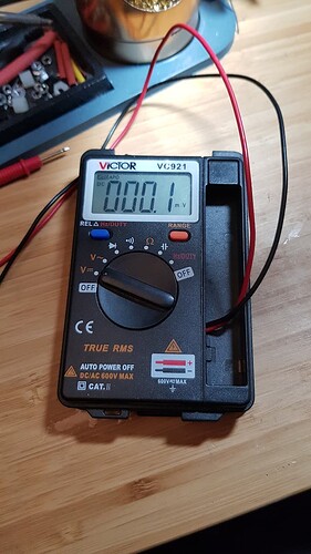

    note to self: need to find one of those self adjusting meters only with current measurments

Voltage across 22R = 4.56 - 2.1 - 2.4 = 0.15 V
Current through 22R = V / R = 0.15 / 22 = 6.8mA
So current through LED circuit == 6.8mA.
Check the voltage across the 22R it should be 0.15V
22 R you mean my 2.2k resistor?
Well say 2K2
Current through 2KR = V / R = 0.15 / 2K2 =0.000068A
So current through LED circuit == 0.068 mA. So no backlight I would say.
Check the voltage across the 2K2.

i believe it's 0.5
That's the base series resistor, not the LED series current limit resistor, what signal are you applying to it with the Nano?
Exactly what two points do you connect the red and green wire to on the I2C board?

redwire goes vcc pin, green wire goes pin 15 which i believe to be LED+
i believe i did the same thing , only instead of BC557 I used PN2222 and instead of 1k R, i used 2.2k resistor.
BC557 is PNP
PN2222 is NPN
yea i've been trying to read about the difference between them, and so far i undertsand NPN should sit on the negative side, and PNP should sit on the positive side.
unfortunatly i don't have BC557, i do have 2N3906,2N2907,2N2907A and 8550 transistors.
At least the 2n3906 would do in this case. It has a different pinout to the BC557.
Note also that in the case of that circuit, a higher PWM duty cycle means a lower backlight LED brightness.
