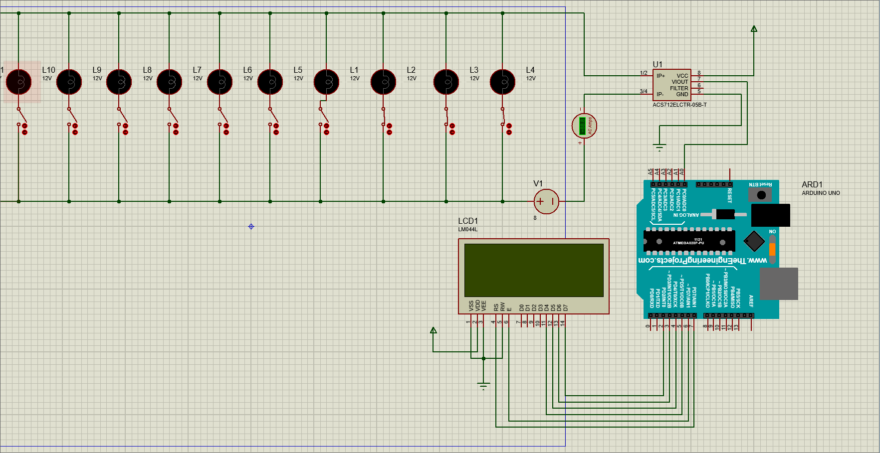

I will add screenshot of the circuit which I've made now. I'm not even sure that this circuit is correct or not though...So I want to get your advice.

The picture looks like it might work but is missing a few parts like power sources. I am assuming the loads are all connected to the source in a parallel configurations and your picture indicates. You are missing the relay, which you could use to turn on and off the loads but when you exceed the 2A and turn off how will you know when to turn it on again. LEDs need series resistors unless they are built in, which you sort of indicate by labeling as 12V. More information such as links to technical information on the hardware parts will help us help you. Also this looks like a classroom project so draw a proper schematic showing all connections. If you give us this information it will help us help you.
Thanks for your comment. By the way this was my mistake and after that I've designed a bit more of circuit from there. I will upload this screenshot together. Most of all our sensor-to-LCD system is working properly by showed us voltage and current through the arduino with code. But the weird thing is as you said it is classroom project but we'd never learn about using relay element to circuit. So that's also the point which I'd like to get some help from here. Can you give me some advice of adding relay circuit and LED on this screenshot's circuit?
Look online there are many tutorials that explain how to use the relay. Remember never connect the relay directly to the arduino it will damage it. Most of the relay boards have isolation in the form of a transistor or opto coupler, this will be shown in the tutorials. Number one rule: A power supply the Arduino is NOT! Give a schematic a try, you can get KiCad for free and it will take you all the way through PC boards if you want to go that far with your design. It has a fairly steep learning curve if you do not have experience with that type of software but you can do it. I will give you a hint, if there were a NO contact in series with V1+...
Of course if you say that it works, it works. However, if it works, you have not built it the way you drew the schematic. In your schematic, the ACS712 actually forms a short circuit that bypasses the Lx loads, the loads are effectively connected in series with your power supply (V1) and there is no connection that allows the Arduino to sample the voltage at the high side of the loads. I second the comment by @gilshultz; try drawing a proper schematic and see if you can make it accurately reflect the real setup you're working with.

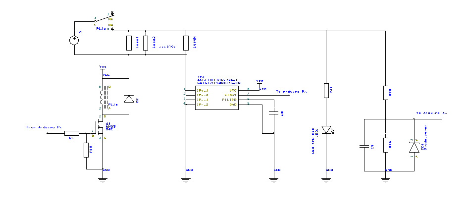

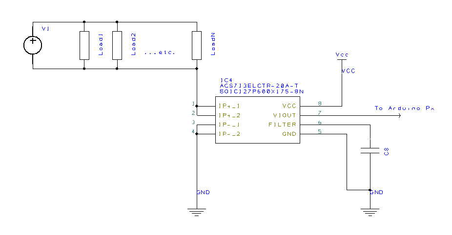

A schematic that would come closer to a working setup could look like this:
(It does not include the Arduino board or the LCD).
If you were to add a couple of things, this might be the outcome:
  • Added relay to switch power to the loads
  • Added power indicator led for loads
  • Added voltage sampling/measurement of load voltage
Note that I included a few components that you may or may not have thought about:
  • C8 is the filtering capacitor for the ACS71x that allows you to apply smoothing to its signal
  • D2 is the obligatory protection diode for the relay coil so you don't fry anything as the relay turns off
  • R6 is an optional gate current limiting resistor which is a matter of taste, but I like adding it
  • R18 ensures the relay isn't turned on if the attached pin of the microcontroller is either not attached or in high-impedance state
  • R21 is the current limiting resistor for the power led; calculate it using Ohm's law to set the desired current through the led
  • R19 & R20 form a voltage divider to bring the Load voltage to an acceptable/safe level for the Arduino to sample on one of its ADC ports
  • C9 (optional) smooths the voltage that's read by the Arduino so you don't get oddly fluctuating readouts
  • ZD1 is an additional protection of the voltage that goes to the Arduino's ADC pin to ensure it doesn't rise beyond a certain level; if your Arduino runs on 5V, I'd pick a 5.1V zener diode for this. The part is optional, but I like to include it
