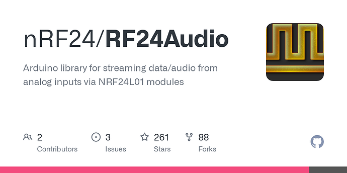

The nRF24L01 is a 2Mbps transceiver, it is more than capable of handling audio given a powerful microcontroller.
For AVR devices there is:
For the Due or the XIAO 52840 there is:
This would be relatively easy to accomplish with either library, you need to assign a separate "pipe" on the radio to handle data. Then whenever you transmit audio, the MCU transmits a bit of data, say on pipe2 using address2, then switches back to pipe1 address1 for audio.
Since the OP's question comes up quite frequently on this forum, with no visible progress, perhaps you could help out the OP and others by pointing to or creating a basic working example of their idea.
Hmm, I have a working example of one-way encrypted communication/walkie talkies using the XIAO 52840, which has a built in radio and microphone:
It uses the same principle of using one pipe for data, and one pipe for audio. Basically you set up the addresses correctly, then just need to call radio.openWritingPipe(yourPipeHere); to choose the data pipe or the audio pipe.
Beyond that I would have to put something together specifically for this, but I don't want to do the whole thing myself. If people are having problems following the documentation etc, I can answer questions and offer help with code etc.
I would however choose to use an arduino due, or due-based board which might make it a bit large. This would allow very good quality audio compared to the other options which are OK for voice, but not that great for other audio.
That looks like a decent starting point, at least for voice, and using a fairly powerful MCU such as the nRF52840. Thanks for posting the link!

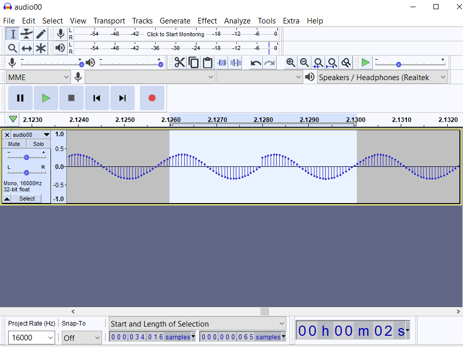

You may recall that we communicated a while back about dropped samples during voice recording to SPI flash with that processor, which was solved by using a very large sample buffer. So, I'm wondering if you checked whether audio samples were dropped in your example with the NRF24.
There is a very simple test, which is to transmit an audio sine wave. Example of the problem, which creates a very irritating buzzing sound.
Yeah I remember now!
The max buffer size default is 1600 for the 52840, so I'd think that is enough for most things, but no I haven't tested it like that. I probably should, and find the best setting that works with the default examples.
It is of course easy enough to modify by editing the config.h file included with the library, but I should still find the lowest number it works cleanly at.
