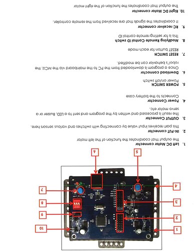

New user here, I’d like to know if I can program a non Arduino board using the Arduino IDE, only thing is that I can’t find anything about this board, it’s called MRT5, it’s got an ATmega32A chip in it

You did not give much information to go on, maybe you could have posted a photo of the board.
Is it the one below?
MRTduino_board
If it is this board then you program it as a Leonardo board, and the info for it is in this link:

There are so-called cores that can be added to the IDE. I think that GitHub - MCUdude/MightyCore: Arduino hardware package for ATmega1284, ATmega644, ATmega324, ATmega324PB, ATmega164, ATmega32, ATmega16 and ATmega8535 supports the 32A.

Thanks for your reply! It’s pretty similar to that image, but it lacks the arduino pins and the function switch, here’s an image of it:
I’ll try programming it as a Leonardo board, thanks again!

here is the manual for it: https://logix5.com/roboticaeducativa/wp-content/uploads/2017/01/mrt5-1.pdf
It looks like its programmed using MRT Scratch and Arduino IDE
