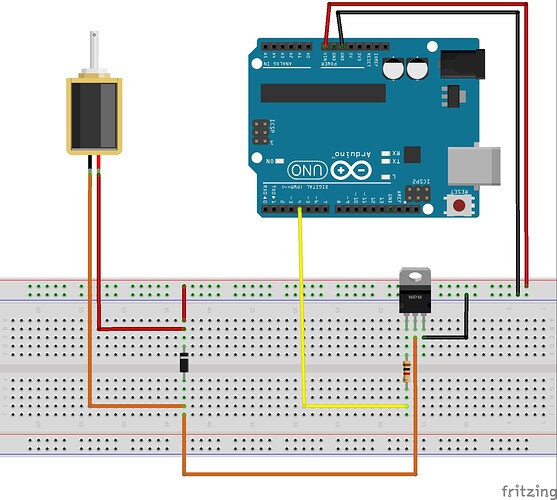

Hi all,
I have 12V 17W solenoid valve, power supply is 12V 8.5A , TIP35C darlington and of course Arduino Uno.
I tried 'the standart solenoid circuit with arduino' and solenoid triggered but valve didn't close and then i checked the current of solenoid is nearly 500mA.
After that i drove only solenoid with power supply. everything is ok and the current of solenoid is 1A.
i think my solenoid needs 1A or higher. What should i do for fix this situation?
Thanks in advance.

i'm using external power supply. Arduino powered by 9V 1A adapter. The circuit powered by 12V 8.5A.
p.s : i cannot reach your attachment . could you refresh it? Thanks.

Larry's image is a jpeg at http://i.imgur.com/f5nBHpB.jpg. Just go to that address to see his file. He doesn't need to refresh anything.
The Darlington may be dropping 1.5V, so the solenoid is not getting the full 12V.
Try using a logic level MOSFET such as stp36nf06l instead of the Darlington.
Don't forget to connect a flyback diode across the solenoid terminals to short any reverse voltage when the solenoid is stitched off.
Vce(on) is 4V, so big volt drop.
Can you replace your base resistor 1K with 150R, it will give you more base current, as Vbe(on) is 2V.
But you would be much better with a MOSFET.

i tried 150R . it still triggered but valve didn't close again. i measured the current is 960mA and then i tried no resistor . the problem is still going on.
i used only valve and power supply such as manually, the current is 1A and valve working perfectly..
how can i fix this problem?

A TIP35 (not a darlington) is a poor choice.
It needs a base current of 100-150mA for that solenoid, and has a high (~2volt) saturation drop.
How long do you think the Arduino will last by trying to force that base current from a 20mA Arduino pin.
