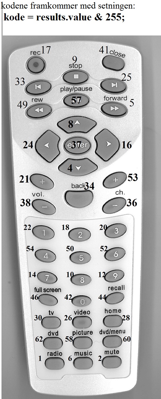

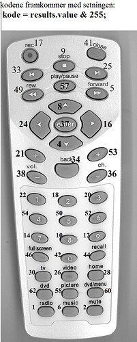

Get the library: GitHub - Arduino-IRremote/Arduino-IRremote: Infrared remote library for Arduino: send and receive infrared signals with multiple protocols
as each button sends a loooong code, add : byte keycode=results.value & 255; // mask to 8 bit
find code for each key u want to use, picture shows on of my remotes..
You can then use a key to incr./decr. servo angle or goto specific angle.

Thank you so much. I did as you said. Now I have values of each key of IR remote. However I cannot figure out how my main body program should be written ? I thought I would store values from IR remote in a array and use array element to write servo angle but there are problems. angle could differ from 0 to 180/360. I want to make sure that I should be angle to write any angle. Lets say use Play key as enter key . Program should write any store value to servo once enter key is pressed? Make sense? Cnnot figure out program tho
