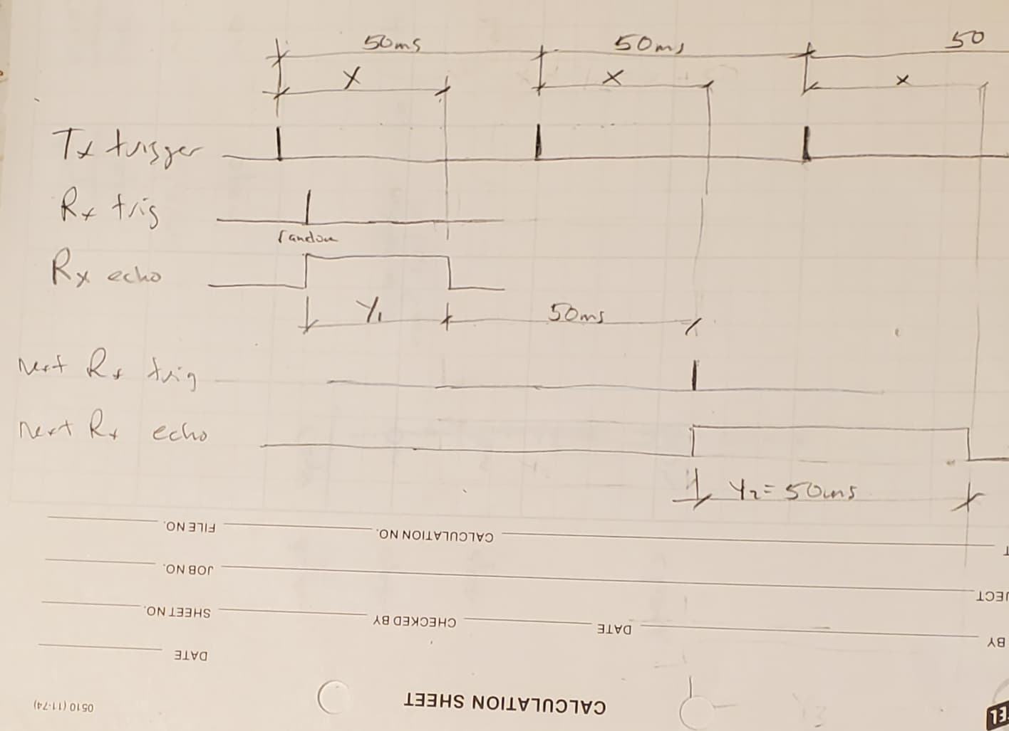

This is brilliant. I like the way how it can be done without any additional hardware. For anyone reading this in the future, here is an image on how the sync is achieved
In the above diagram, the Tx represents Transmitter sensor and Rx represents Receiver sensor. As shown the Transmitter sensor will be made to transmit US waves at a periodic known delay, this is all it has to do.
In the Receiver sensor we have to somehow make the trigger pin go high exactly during when the transmitter pin goes high. So initially we randomly make the Receivers Trigger to go high which will and stay high till the echo pin goes low. This echo pin will go low only when it receives a US wave from the transmitter. So as soon as it goes low we can assume that the Transmitter sensor just got triggered. Now, with this assumption as soon as the echo goes low we can wait for the known delay and then trigger the receivers trigger. This would partially sync the trigger of both the Transmitter and receiver and hence you can read the immediate echo pulse duration using pulseIn() and calculate the distance.

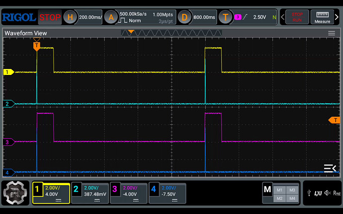

The synchronising could be done using gps.
Give each object a gps receiver, and use the 1PPS (one pulse per second) output to do the synchronising.
In the following oscilloscope traces, the connections are:
  • Channel 1 - gps #1 PPS output
  • Channel 2 - 10µs HC-SR04 #1 trigger pulse
  • Channel 3 - gps #2 PPS output
  • Channel 4 - 10µs HC-SR04 #2 trigger pulse

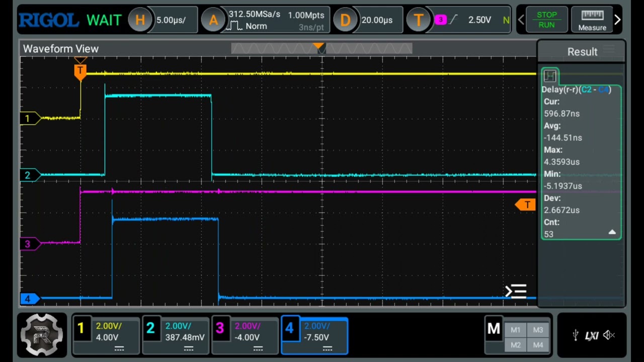

and on a faster time base:

The two gps PPS outputs were within a few nanoseconds of each other.
The pulses to trigger the HC-SR04s were always less than 10µs apart. Sound only travels 3mm in this time.
A. The Rx echo pin goes low when sound from Tx hits Rx, not when "Tx got triggered." There will be an unknown delay between when Tx is triggered and when Rx echo goes low, equal to the time it takes for sound to go from Tx to Rx.
B. So then if you do this...
...then the Tx and Rx are not in sync. The reason can be seen in the following:
where:
X = time for sound to go from Tx to Rx
Y1 = Rx's first measured pulse length, which is random
Y2 = Rx's second measured pulse length (triggered the known delay after receiving the first pulse), equal to approximately the "known delay," not equal to X
Maybe I'm missing something, but I don't see a way for Rx to ever know or even grossly estimate the value of X using this scheme.
Also, this does not implement the @Delta_G method that you quoted at the top of your post.
