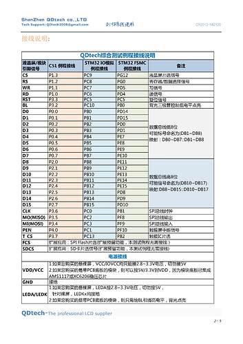

If it is possible, I want try your solution https://forum.arduino.cc/index.php?topic=521034.0 - Album on Imgur that allows to use the screen bought instead of leaving it in a drawer.

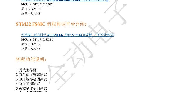

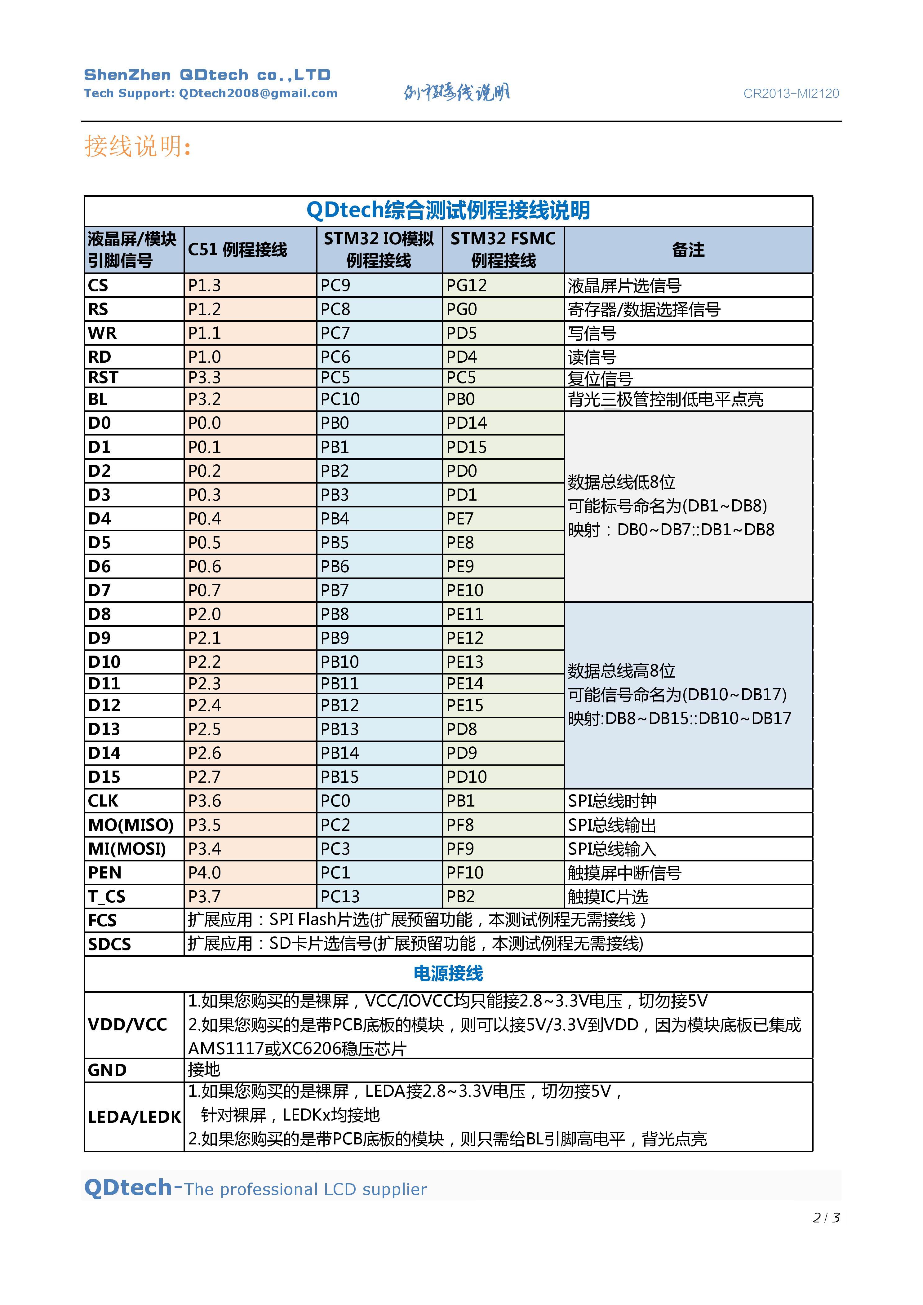

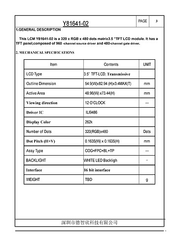

I just received several pdf files from vendor.
I convert all in 29 files jpg and you can see them on :
I think thees 2 pages are most important :
Maybe with theese data, you can help me about the wiring diagram between screen and mega and witch library use ?
You need to buy 3 or 4 level shifter modules or 74LVC245 chips.
You can mount them on a Protoshield pcb with a 17x2 female header.
Yes, there is a lot of work involved.
Buying a 40-pin Adapter Shield means you can use straight jumper wires because the Shield contains the level-shifter chips.
That Adapter has a 32-pin socket which does not match your 34-pin display.
Seriously, it would be cheaper and easier to just buy a Due clone or an STM32 board. These have 3.3V logic and hence do not need level-shifters.
I can help you with library software. When it comes to hardware wiring, you have to do that yourself. (I can tell you which display pin to connect to which level-shifter pin)
Your JPEGs say ILI9486 but then give data for HX8357-B
