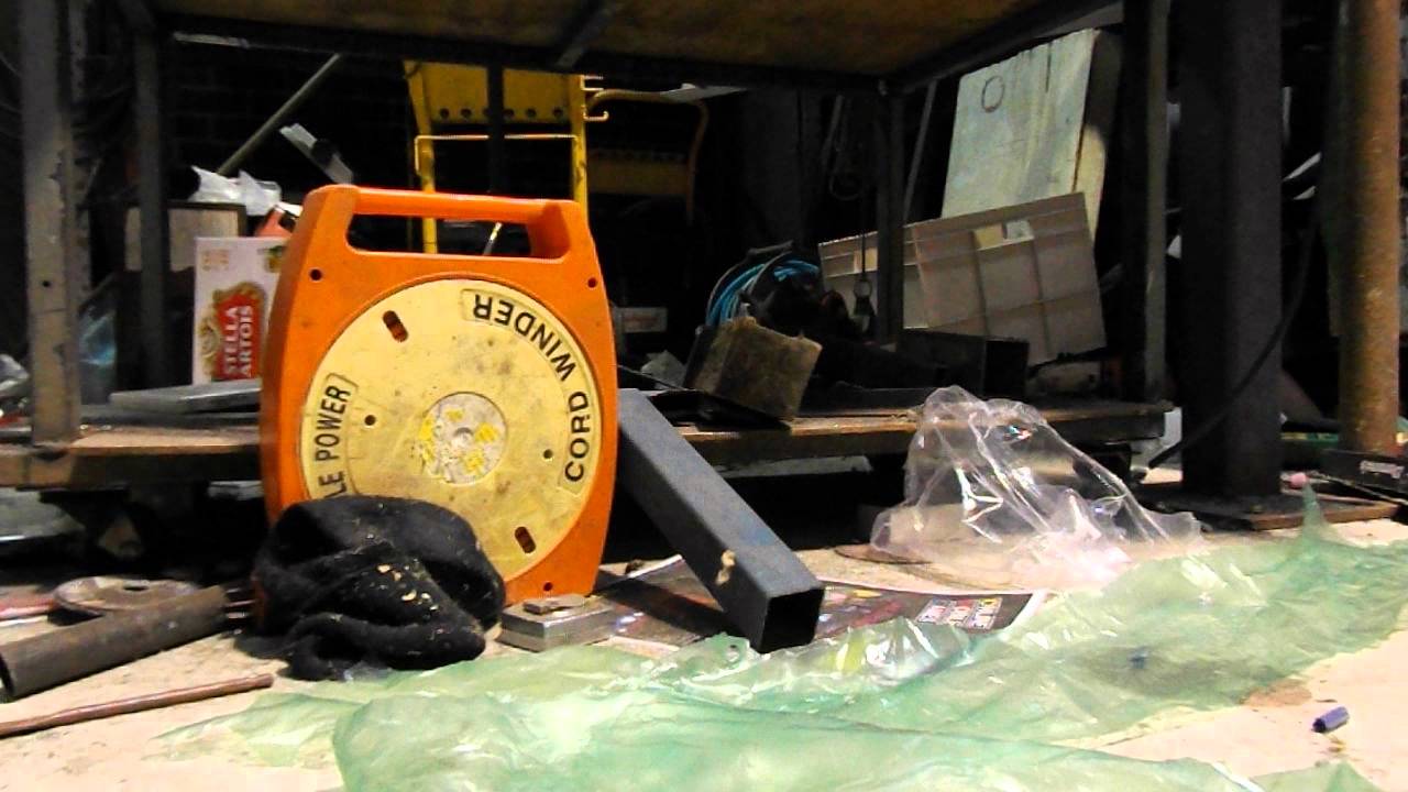

here is the unit I need the code for, eventually I hope to add a pan and tilt, its a little rough but I am happy for a first hand build
