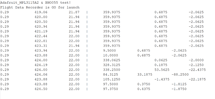

I'm trying to print orientation angles from my BNO055 in a list so I can see all x,y,z values in a single column. However, when the number of digits change, the length of that row changes. How can I fix the spacing and also have the decimal point be in the same place ?
That's a problem with how your terminal interprets a tab character.

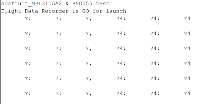

I tried using that code. It's properly formatted now thanks. Unfortunately, the values aren't showing up. All of the variables are floats. Also, what is the purpose of the '4' after %8f ?

sprintf (buffer, "%8f:%8f:%8f,%8f4:%8f4:%8f4", pascals/3377, altm, tempC, event.orientation.x, event.orientation.y, event.orientation.z);
Serial.println(buffer);
Serial.println();
The IDE does not support the float data type in sprintf(). There is a way to enable floats in sprintf(), but I don't know where to find it. Maybe a search of this forum will turn it up.
The alternative is to use the dtostrf() function to convert the floats to strings and use the %s placeholder in sprintf to print them.
