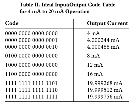

How about an AD421, send a 16 bit number from MCU via SPI, get a variable current (can be 4 ~ 20mA) out.
table1
AD421
This is a $20 chip, so rather not, I am looking for the cheapest solution, not the most convenient if it makes my boards too expensive to make, this means that the price of 10 boards is in the 300 USD range, and I rather not spend that amount if I absolutely do not have to
DAC161P997 Single-Wire 16-bit DAC for 4- to 20-mA Loops
is more like that I want, but it is still $6 chip, but it is packed with features like HART communication interface if using the right hardware.
