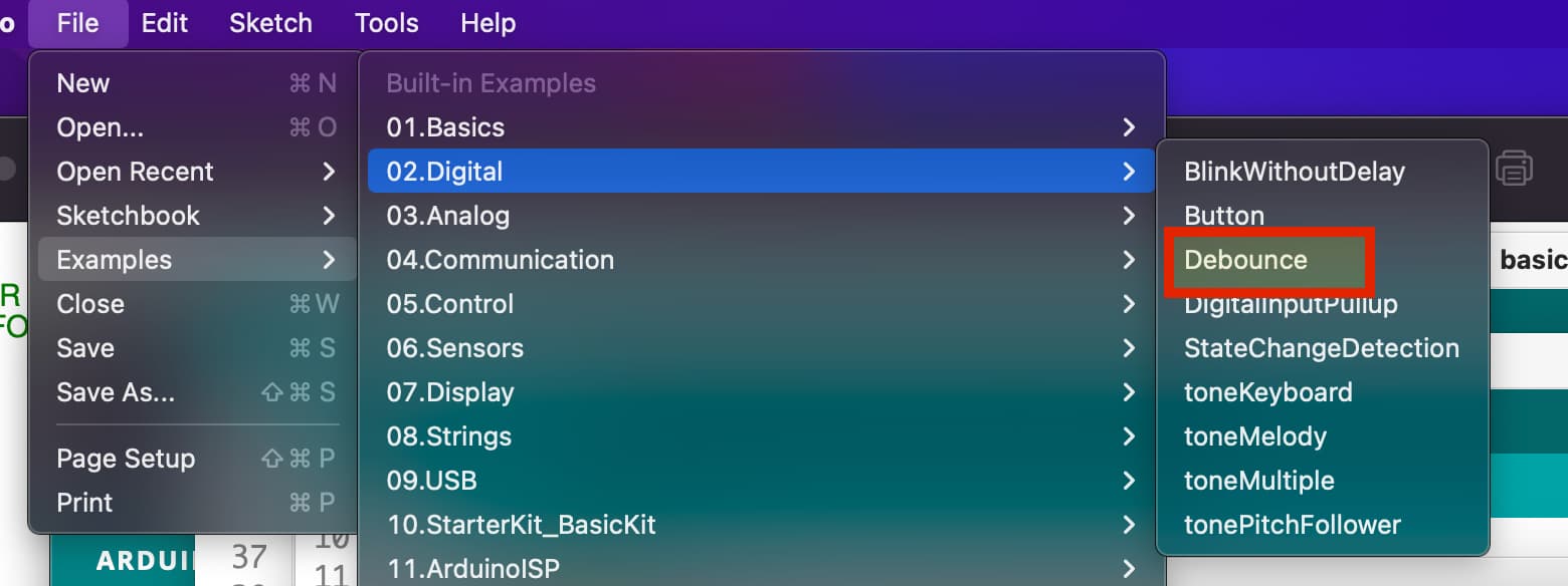

ALL contacts, switches and buttons bounce and go on and off several times for a few milliseconds. This would be equivalent to multiple presses of the switch.
What you need is to include code for debouncing. You can find an example in the Arduino IDE, and many more in this forum and elsewhere.
And please post your code (not pictures). Chances are you are already debouncing...

Ok, one step at a time. Although not "formally", this line gets the debouncing out of the way.
Now, try changing
to this:
//Extra Switch 3a
  if (switchFive != switchFiveState)
    Serial.println("Extra Switch 3a");
    switchFiveState = switchFive;
You can read a discussion on the debouncing issue here: https://forum.arduino.cc/t/leading-edge-debouncing/964407
