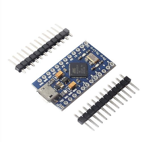

Hi everyone I'm building up a button box with 4 x 4 of 3 way switch(on-on) , I'm using the arduino pro micro but, I plug the first ones to their corresponding for example A3 and 14 etc etc, but when Im requested to wire from a switch to another, everything screw up. So when I plugged everything from the board it was OK but when I started the bridges between switches it started outputting the whole column.. The switches have 3 pole how should I plug them? (maybe I've done something wrong) .... ....

If you are wiring switches in a matrix and more than two will be on at any one time, you will need diodes in series with each switch. ![]()

This is all the wiring I've done so far, I'm a real newbie on this, if someone could do a better wiring scheme would be appreciated, on the right you can see where I get the error, thanks a lot, appreciate your support

From what I can see you are using 6 I/O to read 8 switches by wiring them in an row/column array, you will probably need diodes associated with each switch to enable you to identify more than one switch ON at a time.
The pin labeling of the ProMini after pin 10 is not clear, D10 then D11, D12, D13.
Can you make that clearer please?

Yup, Pro Micro, my mistake to say Pro Mini.
