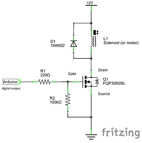

yes I did it is wired exactly like the diagram except the pump is on alligator clips

You will need a diode to connect in parallel with the motor, but in reverse. I say fly wheel diode, but there are other names:
When something inductive (the motor) is turned off, a voltage spike will occur that can damage, in this case, the transistor. The diode is there to let the spike go back to positive voltage.

the things it says on the transistor are 8a28rl and p3ono6le
and would a diode rectifier work?

An old FET, but it'll do the job. You need a couple of resistors, and this is actually a schematics and components resembling your setup... hm :slight_smile:
Source https://www.g7smy.co.uk/
Sure, you got 4 diodes in a bridge. Can you figure out how to connect it? Only two legs are needed.
About the PSU('s?) and the pump, if you don't know at how many amps they are rated, I guess you just have to take a dice... And never ever run the pump like in your diagram, your Arduino will suffer the consequence.
thank you I think that I finally figured it out.
