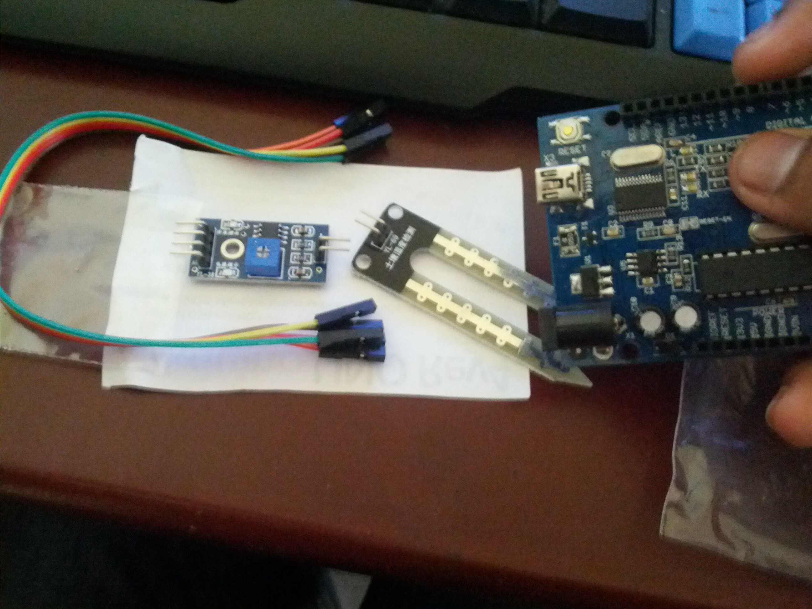

I bought the arduino and the sensor, they are pictured below
How would I go about connecting the sensor to the arduino? I'd require only the analog input and not the digital
I realise the two connectors on the LM 393 should be connected to the two connectors on the sensor
And the four on the other side of the LM393 should go to 1. Power supply (5V connector on the arduino) 2. Ground (GND on the arduino) And one for the analog output (A0 On the arduino)
It's just that I dont know how to connect it... Do I use the given set of four to four connectors to connect the Sensor to the LM 393 or four the LM 393 to the arduino? And if so what do I use to connect the rest?

Are you asking what the circuit design should be, or the practicality of how you make an electrical connection between a terminal on the Arduino and a terminal on your sensor board?

Probably the practicality
While I was waiting, I did some research of my own, and I think the wires given with the sensor are called Dupont Wires, and they are Female-Female, and there are five of them. So this would work for connecting the sensor terminal to the LM393 chip terminal.
Now connecting the LM393 chip to the arduino is a different case, I'm guessing the Arduino requires a male cable? So would I have to buy a female to male wire? and then connect the female side to the chip and sensor combination, and the male to the arduino? (Buy one each for VCC, GND and A0)
Again this is all assumption based on what I've read online and read on different sensor manuals.
Thanks for the help and Interest again :slight_smile: Appreciate it (Y)
Your UNO has female headers. You have some female jumper wires. To connect these together you need some male-to-male jumper wires, which might be properly made for the purpose or just some solid core wire with the ends stripped. This sort of thing is commonly available in electronic hobby shops. If you don't have access to anything like that, you can just use the snipped-off end of a sewing pin, or a strand taken out of a heavier wire, or anything else that is physically the right size and conductive which you can push into the terminals. If you're looking for a better long term solution, it's possible to get the crimp terminals and housing blocks separately so you could replace the female terminal on one end of those wires with a male terminal, or make up your own connector cable from scratch. Putting all the terminals in a single housing gives much better mechanical support to the connector than using a separate shroud for each terminal, as you have currently.
PeterH:
Will be getting some male to male connectors then.
Currently all the female jumper wires and glued together, however they are easily removed, it is safe to remove them so i can use two for the sensor and the other three for teh VCC, GND and A0, Right?
I dont get the part about crimp terminals, are you talking about making a housing for the whole project? If so I don't think that is necessary at the moment.
What do you mean by a seperate shroud for each terminal? You mean im using one wire per terminal?
Anyway will be buying make to male connectors, Or would it be simpler to use a female to male connector to connect the LM393 chip to the Arduino? You know, instead of a female to female to male to male, I could just use the female to male

If you remove the black plastic piece from the end of the leads you already have, you'll see this is basically what they are. The black housings are available in various sizes from one up to a dozen or so terminals. As well as the female terminals shown there, you can get similar male terminals. Both sorts just crimp onto the end of a wire.
Given that you already have some individual housings, gluing them together is perfectly OK to make a bigger housing.
If you decide to buy any more terminals and/or housings, you should know that they're bog standard 0.1" pitch connectors and you should plan to buy a bag of a hundred or so for a few pence each. Buying then individually as advertised in that link is extraordinarily expensive.
In the short term, buying male-to-male jumper wires, or just finding a bit of metal to join the two female connectors together is a perfectly reasonable way to complete your circuit for testing.

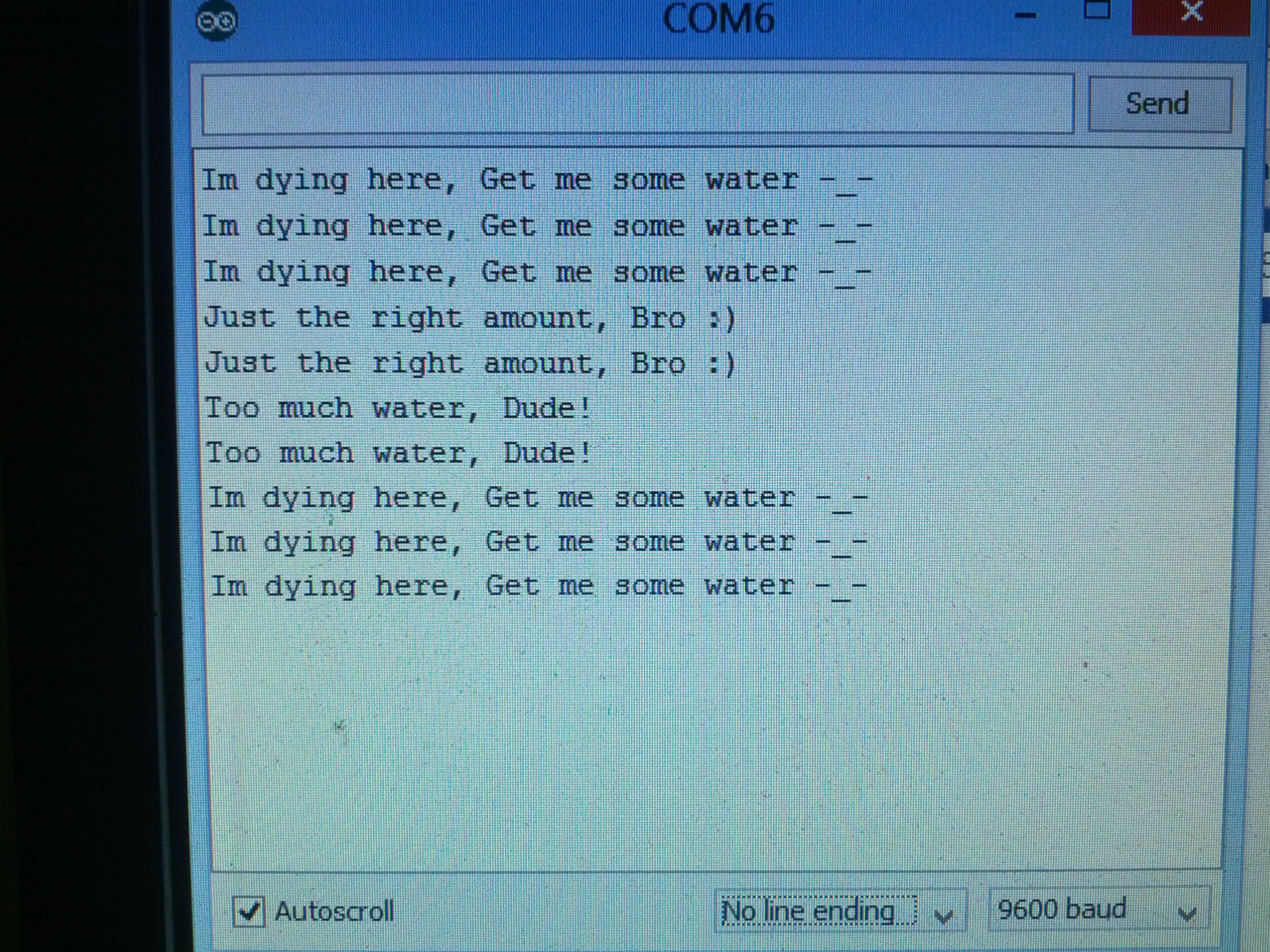

Connected it using wires I found from random wire in my house, and I'm glad to say it works :slight_smile:
Managed to get it to output values like this
That is being not in water at all, then slightly submerged and then completely submerged. :slight_smile:

Yup I got that part, I wrote a bit of code that Outputs a sentence depending on the water level, For example "Too much water" if there is too much water and "Need more water" if there is less water etc..
